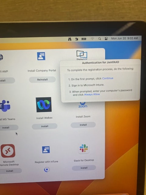

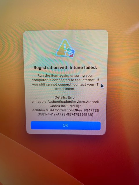

I installed the beta of the new macOS Ventura to test things before Apple starts shipping laptops with it in the fall. I am running into errors when trying to register with InTune (surprise surprise). I get the initial Authentication for JamfAAD pop up with the instructions, that immediately disappears and I get the Registration with Intune failed error box.
Thoughts?

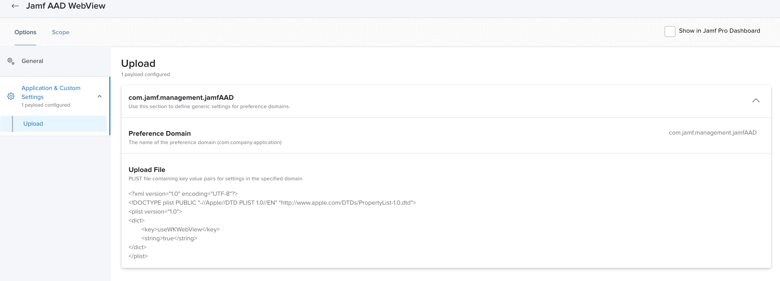

Are you using https://docs.microsoft.com/en-us/mem/intune/configuration/use-enterprise-sso-plug-in-ios-ipados-macos-with-jamf-pro ? and or Jamf AAD Webview for enrollment? We have had much better luck since we started using Webview. Push this config profile before enrolling into MS CA. (Not sure if it needs a restart as well)
same error after doing the Jamf AAD Webview for enrollment, even after a restart.

/Library/Application\\ Support/JAMF/Jamf.app/Contents/MacOS/JamfAAD.app/Contents/MacOS/JamfAAD gatherAADInfo -disable-cache-read
same error, just in the terminal window
For me adding the WebView  CP worked.
