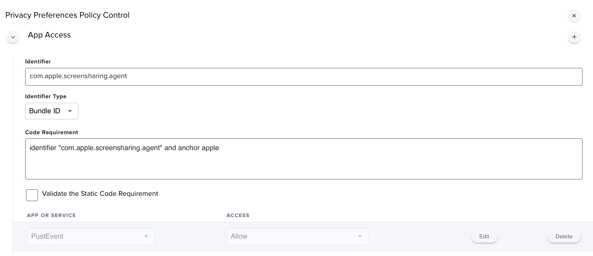

Are you deploying a privacy preference for the screen sharing service? as kickstart alone won't do anymore.

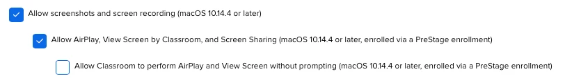

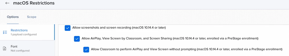

At first glance, that error you saw was appearing for people that had not enabled remote control via MDM / API after apple made the system changes in macOS 12.1. Have you test your workflow by manually enabling remote desktop using the button in Jamf for that device instead of api?
I would also see if a device profile assigned with the following restrictions payload helps. I run but haven't gone back to see if removing makes a difference.

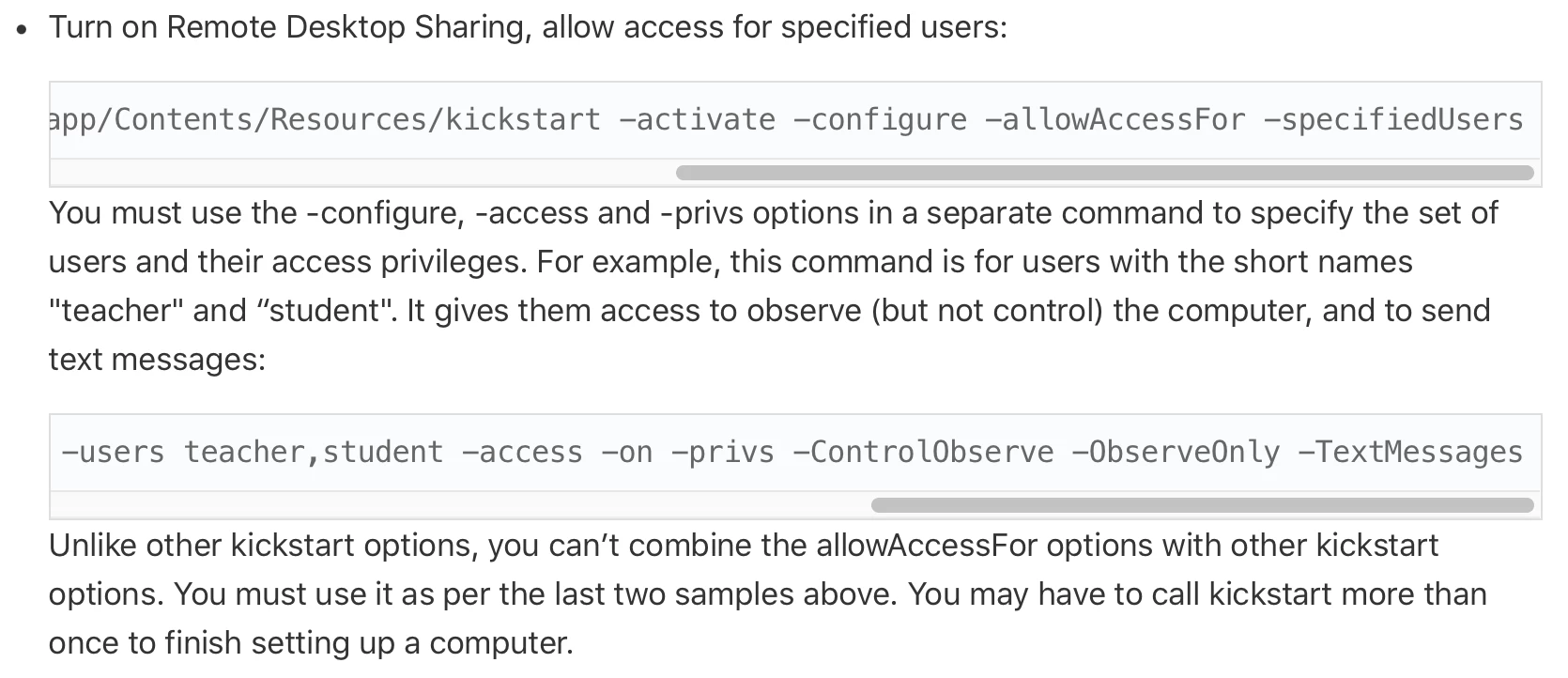

If using Kickstart to specify a user and privs, are you doing this on seperate lines as apple's docs show;
https://support.apple.com/en-au/HT201710

Resetting privacy preferences should not have any effect, but it does:

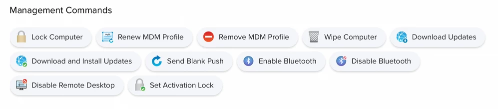

I manually activate the remote management through the management tab of the computer informations in Jamf or I activate it with the script below. When I control the computer and do a tccutil reset All, the connection is lost: the screen of the remote management is fix, I can't see the mouse moving inside the window. If I quit ARD and start it back, when I want to control the computer, the connection window still shows that it's connecting, but nothing happens. And once I reboot the computer, the severUnableToReadScreenMessage error dialog box appears. If I run the script (I have it in Self service for this in my test lab) or activate it with the button in the management tab, it then works again until I do another tccutil reset All. Believe me, it happens every time with Monterey and Ventura.
For the configuration profile, I have it, except that I didn't checked the third box. Do I have to check it ?

I just noticed that you run 3 commands for the kickstart. I'll change that later today.

More info about ARD broken when I run a tccutil reset All: while I don't restart the computer, I can see what happens in ARD, but can't control the computer remotely.
Run tccutil reset All again then use the following commands to view logs;
/usr/bin/log show --predicate 'subsystem == "com.apple.TCC"' --info --last 1h
Search for: target_executable_path_URL, bundleID, static code for, result: Auth
If you have those previously mentioned profiles deployed there shouldn't really be a tcc issue but these logs should help show any errors if there.
If you haven't tried it's worth a look but I don't think it would have any effect, might as well tick it off the list.
I used to have only two lines but found when I included the options below on the last command, it wouldn't correctly apply my set permissions. Only the default Show / Observe would be in effect which is what you get from enabling ARD via api or jamf gui button on the device record.
