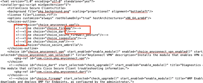

dlbrabb
  • Nov 17, 2022 5:52 PM UTC
I run the "pkgutil --expand" to open the AnyConnect PKG.  Then open the Distribution file.  You can then action out the products you don't want to install.  Once you have completed this, you can save and flatten the file.  Then you only have the PKG to install, no other scripts needed.  I have included the Distribution file we use.  It only installs Cisco AnyConnect and Umbrella.  Just be aware that this is version specific and my example only works with 5.0.00556.
<?xml version="1.0" encoding="utf-8" standalone="yes"?> <installer-gui-script minSpecVersion="1"> <title>Cisco Secure Client</title> <background file="pkg_background.png" scaling="proportional" alignment="bottomleft"/> <license file="License.rtf"/> <options customize="always" rootVolumeOnly="true" hostArchitectures="x86_64,arm64"/> <choices-outline> <line choice="choice_anyconnect_vpn"/> <!--<line choice="choice_fireamp"/>--> <!--<line choice="choice_dart"/>--> <!--<line choice="choice_secure_firewall_posture"/>--> <!--<line choice="choice_iseposture"/>--> <!--<line choice="choice_nvm"/>--> <line choice="choice_secure_umbrella"/> </choices-outline> <choice id="choice_anyconnect_vpn" start_enabled="enable_module()" enabled="choice_anyconnect_vpn_enabled()" start_selected="check_upgrade()" selected="choice_anyconnect_vpn_selected()" title="AnyConnect VPN" description="Installs the module that enables VPN capabilities."> <pkg-ref id="com.cisco.pkg.anyconnect.vpn"/> </choice> <!--<choice id="choice_dart" start_selected="check_upgrade()" start_enabled="enable_module()" title="Diagnostics and Reporting Tool" description="Installs the module that collects Cisco Secure Client troubleshooting information."> <pkg-ref id="com.cisco.pkg.anyconnect.dart"/> </choice>--> <!--<choice id="choice_fireamp" start_selected="check_upgrade()" start_enabled="enable_module()" title="AMP Enabler" description="Installs the module that downloads and deploys AMP for Endpoints, as configured by the administrator."> <pkg-ref id="com.cisco.pkg.anyconnect.fireamp"/> </choice>--> <!--<choice id="choice_secure_firewall_posture" start_selected="check_upgrade()" start_enabled="enable_module()" title="Secure Firewall Posture" description="Installs the module that provides the Cisco Secure Client with the ability to identify the operating system, antivirus, antispyware, and firewall software installed on the host prior to creating a remote access connection to the secure gateway."> <pkg-ref id="com.cisco.pkg.anyconnect.posture"/> </choice>--> <!--<choice id="choice_iseposture" start_selected="check_upgrade()" start_enabled="enable_module()" title="ISE Posture" description="Installs the module that provides the Cisco Secure Client with the functionality needed to authenticate to wired or wireless networks controlled by the Identity Services Engine, including examination and any needed remediation of the connecting host environment."> <pkg-ref id="com.cisco.pkg.anyconnect.iseposture"/> </choice>--> <!--<choice id="choice_nvm" start_selected="check_upgrade()" start_enabled="enable_module()" title="Network Visibility Module" description="Installs the Network Visibility Module which collects application telemetry data."> <pkg-ref id="com.cisco.pkg.anyconnect.nvm_v2"/> </choice>--> <choice id="choice_secure_umbrella" start_selected="check_upgrade()" start_enabled="enable_module()" title="Umbrella" description="Installs the module that enables Umbrella."> <pkg-ref id="com.cisco.pkg.anyconnect.umbrella"/> </choice> <pkg-ref id="com.cisco.pkg.anyconnect.vpn" version="5.0.00556" installKBytes="58771">#vpn_module.pkg</pkg-ref> <!--<pkg-ref id="com.cisco.pkg.anyconnect.dart" version="5.0.00556" installKBytes="9986">#dart_module.pkg</pkg-ref>--> <!--<pkg-ref id="com.cisco.pkg.anyconnect.fireamp" version="5.0.00556" installKBytes="1355">#fireamp_module.pkg</pkg-ref>--> <!--<pkg-ref id="com.cisco.pkg.anyconnect.posture" version="5.0.00556" installKBytes="67636">#posture_module.pkg</pkg-ref>--> <!--<pkg-ref id="com.cisco.pkg.anyconnect.iseposture" version="5.0.00556" installKBytes="7965">#iseposture_module.pkg</pkg-ref>--> <!--<pkg-ref id="com.cisco.pkg.anyconnect.nvm_v2" version="5.0.00556" installKBytes="12621">#nvm_module.pkg</pkg-ref>--> <pkg-ref id="com.cisco.pkg.anyconnect.umbrella" version="5.0.00556" installKBytes="20522">#umbrella_module.pkg</pkg-ref> <installation-check script="InstallationCheck()"/> <volume-check script="VolumeCheck()"/> <script> var gUpgradeModules = []; function check_upgrade() { var modulePkgInfo = my.choice.packages[0]; var moduleReceipt = my.target.receiptForIdentifier(modulePkgInfo.identifier); if (moduleReceipt) { var comparison = system.compareVersions(moduleReceipt.version, modulePkgInfo.version); if (comparison == 0) { system.log("Found an existing installed version: " + my.choice.title); return false; } } gUpgradeModules.push(my.choice.id); return true; } function enable_module() { var moduleID = my.choice.id; return (gUpgradeModules.indexOf(moduleID) &gt; -1); } function InstallationCheck() { if(!(system.compareVersions(system.version.ProductVersion, '10.9') &gt;= 0)) { my.result.title = 'Cisco Secure Client'; my.result.message = 'This software requires Mac OS X version 10.9 or later.'; my.result.type = 'Fatal'; return false; } return true; } function VolumeCheck() { // version of VPN being installed has to be higher than the version already installed var vpnReceipt = my.target.receiptForIdentifier("com.cisco.pkg.anyconnect.vpn"); var vpnPackage = choices.choice_anyconnect_vpn.packages[0]; // if the receipt is not there assume no VPN installed or pre-3.1.1 version so it is OK to install if (vpnReceipt) { // there is a 3.1.1+ version of VPN already installed // check to see if version in this package is newer var comparison = system.compareVersions(vpnReceipt.version, vpnPackage.version); if (comparison &gt; 0) { // installed version is newer my.result.message = 'Newer version ' + vpnReceipt.version + ' of the Cisco Secure Client is already installed.'; my.result.type = 'Fatal'; return false; } } // Check if standalone NVM is installed var nvmStandaloneReceipt = my.target.receiptForIdentifier("com.cisco.pkg.anyconnect.nvmstandalone"); if(nvmStandaloneReceipt) { // if version of standalone NVM installed is greater than AC package version, fail with an error message var comparison = system.compareVersions(nvmStandaloneReceipt.version, vpnPackage.version); if (comparison &gt; 0) { my.result.message = 'Version ' + nvmStandaloneReceipt.version + ' of Cisco Secure Client - Standalone Network Visibility Module is already installed.'; my.result.type = 'Fatal'; return false; } } return true; } function choice_anyconnect_vpn_enabled() { if (!enable_module()) { return false; } return (!choices.choice_secure_firewall_posture.selected &amp;&amp; !choices.choice_iseposture.selected &amp;&amp; !choices.choice_fireamp.selected &amp;&amp; !choices.choice_nvm.selected &amp;&amp; !choices.choice_secure_umbrella.selected); } function choice_anyconnect_vpn_selected() { if (!enable_module()) { return false; } var tSelected; tSelected=((choices.choice_secure_firewall_posture.selected || choices.choice_iseposture.selected || choices.choice_fireamp.selected || choices.choice_nvm.selected || choices.choice_secure_umbrella.selected) || (!choices.choice_secure_firewall_posture.selected &amp;&amp; !choices.choice_iseposture.selected &amp;&amp; !choices.choice_fireamp.selected &amp;&amp; !choices.choice_nvm.selected &amp;&amp; !choices.choice_secure_umbrella.selected)); if (choice_anyconnect_vpn_enabled()==false) { return tSelected; } return (tSelected &amp;&amp; my.choice.selected); } </script> <pkg-ref id="com.cisco.pkg.anyconnect.vpn"> <bundle-version> <bundle CFBundleShortVersionString="5.0.00556" CFBundleVersion="5.0.00556" id="com.cisco.anyconnect.gui" path="Applications/Cisco/Cisco Secure Client.app"/> <!--<bundle CFBundleShortVersionString="5.0.00556" CFBundleVersion="5.0.00556" id="com.cisco.anyconnect.uninstaller" path="Applications/Cisco/Uninstall Cisco Secure Client.app"/> <bundle CFBundleVersion="5.0.00556" id="com.cisco.anyconnect.vpndownloader" path="opt/cisco/secureclient/bin/vpndownloader.app"/>--> <bundle CFBundleShortVersionString="5.0.00556" CFBundleVersion="5.0.00556" id="com.cisco.anyconnect.macos.acsock" path="Applications/Cisco/Cisco Secure Client - Socket Filter.app"/> <bundle CFBundleShortVersionString="5.0.00556" CFBundleVersion="5.0.00556" id="com.cisco.anyconnect.notification" path="opt/cisco/secureclient/kdf/bin/Cisco Secure Client - Notification.app"/> </bundle-version> </pkg-ref> <!--<pkg-ref id="com.cisco.pkg.anyconnect.fireamp"> <bundle-version/> </pkg-ref>--> <!--<pkg-ref id="com.cisco.pkg.anyconnect.dart"> <bundle-version> <bundle CFBundleShortVersionString="5.0.00556" CFBundleVersion="5.0.00556" id="com.cisco.anyconnect.dart" path="Applications/Cisco/Cisco Secure Client - DART.app"/> <bundle CFBundleShortVersionString="5.0.00556" CFBundleVersion="5.0.00556" id="com.cisco.anyconnect.dartuninstaller" path="Applications/Cisco/Uninstall Cisco Secure Client - DART.app"/> </bundle-version> </pkg-ref>--> <!--<pkg-ref id="com.cisco.pkg.anyconnect.posture"> <bundle-version/> </pkg-ref>--> <!--<pkg-ref id="com.cisco.pkg.anyconnect.iseposture"> <bundle-version/> </pkg-ref>--> <!--<pkg-ref id="com.cisco.pkg.anyconnect.nvm_v2"> <bundle-version/> </pkg-ref>--> <pkg-ref id="com.cisco.pkg.anyconnect.umbrella"> <bundle-version> <bundle CFBundleVersion="1.7.0" id="com.opendns.OpenDNS-Diagnostic" path="opt/cisco/secureclient/bin/UmbrellaDiagnostic.app"/> </bundle-version> </pkg-ref> </installer-gui-script>
