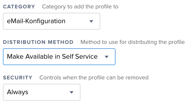

Hey everyone,
We deploy different mail configurations via Self Service which works fine. But in some cases the user wants to remove a profile again. I know that all MDM delivered accounts are listed under Settings -> General -> Profiles -> MDM Profile -> Accounts. But there is no option to remove the profile.
In Jamf i enabled the removal of the profile.
Also i didn't found any option in jamf to remove specific profiles. Is this also not possible?
Thank you all!

  • February 12, 2020
Yes, i have that option set, but my user cannot see the 'remove' button. It's just 'Reinstall'. Is there maybe something wrong with my self service?

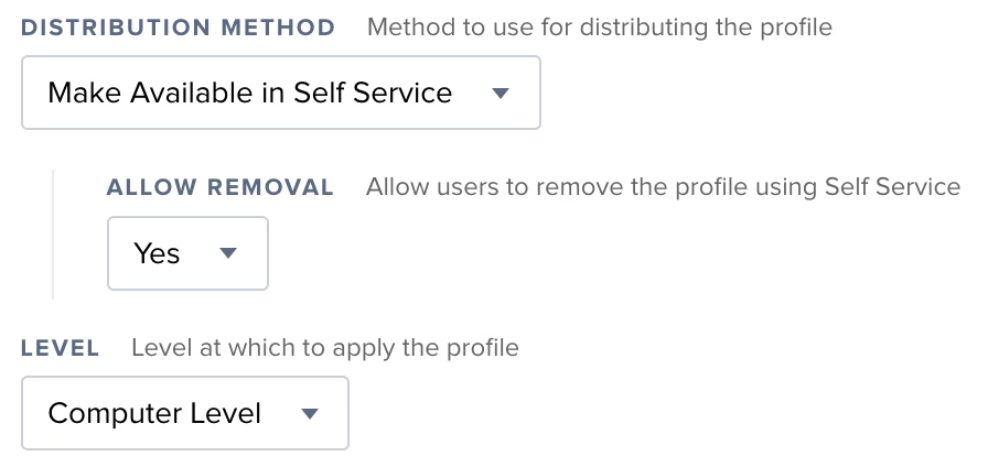

But.... I just noticed something! In your screenshot above, the option I see in it is labeled "Security Controls when the profile can be removed". What version of Jamf Pro are you using? Because on my 10.18.0 instance, the option looks different. See what I mean below
In mine it says "Allow removal - Allow users to remove the profile using Self Service"
So there's some difference between what you're seeing and what I'm seeing that I don't quite understand.
  • February 17, 2020
I have 'your' look only within macOS profiles. With iOS profiles i only have the options displayed in 'mine' screenshot...
I am really confused. Since there is an option to make it removeable, but there is no way to remove it...

My response from support:
It does look like this is a current Product Issue, and I have tied this case to that Product Issue. This is PI-008020. The current workaround for this on enrolled machines is to change distribution method to 'Make Available in Self Service' and select 'Yes' for 'Allow Removal - Allow users to remove the profile using Self Service'. This would then need to go to Self Service to allow this to be removed. Our development team is aware of this Product Issue and a fix should be available in a future version of Jamf Pro.
