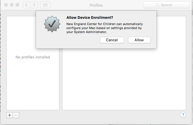

I bought a used Macbook and have updated it to the latest Mavericks. From when I first powered it on I have been getting prompts to enroll the device. I can't get them to go away...only cancel them and they reappear dozens of times per day.
I guess the folks who sold the machine have it in their DEP server? Or there is an agent that keeps checking?
How can I disable the agent that keeps prompting me to join?
Could not figure out after 30 minutes searching JAMF and other sites discussions of the various woes of school IT admins. :(

Until the original owner removes it from DEP it will basically continue to do this.
There are two places the info is stored.
Apple has the device listed as belonging to a certain organisation.
That organisation has the device set to auto enroll.
Both listings are effectively controlled by the organisation so they are the ones to contact to stop it.
It's an inbuilt function within OS X not something that is installed or added later so not easy to disable and really should be dealt with by contacting the original owner.
Even if the machine is completely wiped and reinstalled the moment it hits the internet it will return.

If you purchased that machine from the organization in the prompt, you should contact them to help un-enroll the device (ideally they would have done so already if they were selling it).
  • Oct 21, 2015 9:02 PM UTC
Piggy backing on what Emily said: If you bought it from another party (not in the prompt) as a legit 3rd part sale, I would still contact the organization, ask for the IT department and explain the situation. Likely, they will cut their losses and help you out since you didn't remove it from their possession.
They may want it back, which if they do, I would recommend just sending back. It truly is a brick and pointless to keep/use until it is either enrolled or removed from their DEP enrollment. This is exactly why it's built this way.

Yep the Center for Children says they overlooked removing the machine from their DEP and has now done it. Though it hasn't cleared the alert 4 days later. So now onto Apple.
Which means despite the very wise commentary of posters above there seems to be issues with both Apple and the DEP admins, and none with the wholesale used laptop company that sells Macs via the suspicious internet site Amazon.com

@rangert you'll likely have to track down the organization that is listed to ask them to remove the device from their DEP instance. If the device wasn't lost or stolen they will likely be happy to remove it from their DEP portal. That's really the only way to get around this issue.
  • Dec 2, 2016 8:09 PM UTC
@mpermann, Thank you.
I made a phone call to their main number and got a name/email for someone who would actually do it, so we shall see how that goes. Also, I talked to Apple Tech support and after some consulting with Enterprise tech support they confirmed it is just the former owners that need to remove it, Apple has nothing to do with removing the system from DEP.

With my experience, once the device is disowned through apple business manager and then also refreshed in Jamf Pro a reinstall is needed to remove that prompt.
I think jamf explained that it saves a file on the machine somewhere from memory but that was years ago ha

I refurbish e-waste and tech surplus , I get dep stuff often and sometimes it's not possible to achieve un-enrollment. What you do to disable the popup is delete the folder /var/db/configurationprofiles and delete mdm and Managed (stars and capital letters important) from /system/library/launchagents and launchdaemons.

Above steps will stop the pop-up but do not address the binary. Device will still be re-enrolled if you restore the OS and the process starts again.

Ok, not sure if you still require this but here goes...
The "check-in" to ABM (Aple Business Manager) ONLY happens at the setup stage, which means the following holds true
1) If you install a new OS from Apple and disable your internet at the setup stage, nothing will get installed.
2) You could also use a USB installer with the internet disabled and that will keep the MDM from installing.
Last but not the least, you can go the hacker way to ensure it never happens again.
1) Setup a Launch Agent or Daemon with a script which runs all the time in the background ( every 5 minutes - recommended ) and does the following:
I. Checks for any installed profiles (use "man profiles" to see your options in the terminal manual)
ii. Do a grep for "MDM Profile" or "MDM" it is the standard name for all management profiles
iii. Grab the UUID of the profiles with MDM in the name, I think the label is -u in terminal
iv. Then gut the life out of it with - sudo profiles -R {UUID}
You will need to be handy with command line to get it to work but it is possible, I did some profile coding a long time ago.
