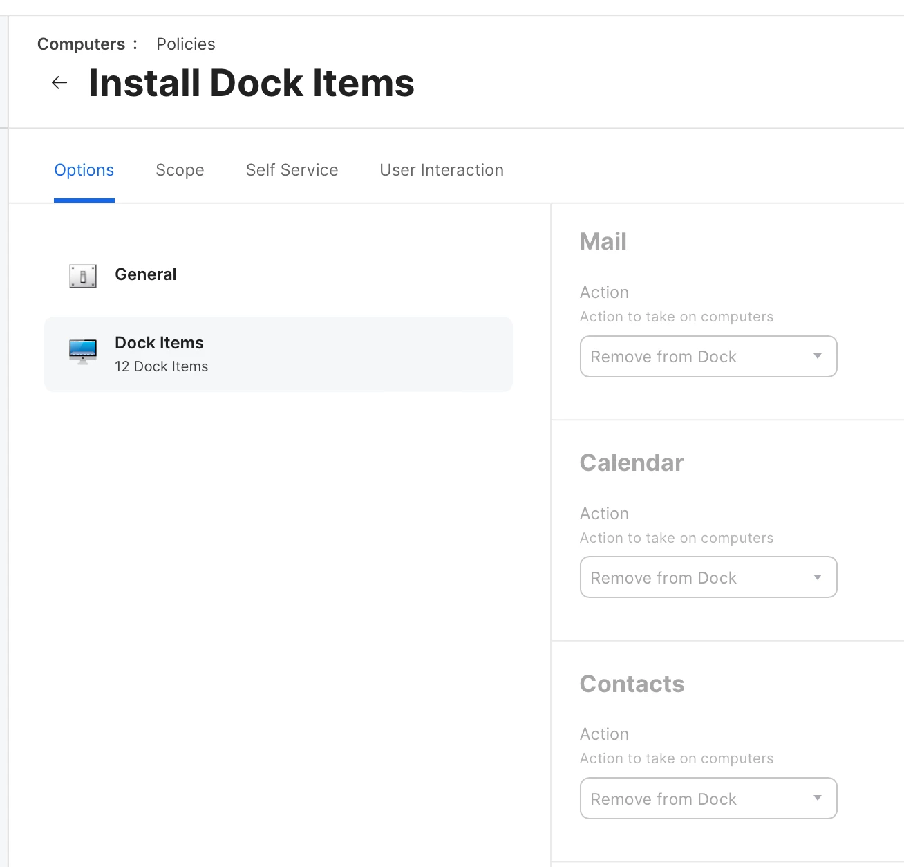

I am trying to remove and add some Dockitems to our new Users, so far it goes well with the Built in Tool and policies. Just these three Apps don't work.
I am using the following path
file://localhost/System/Applications/TV.app/
file://localhost/System/Applications/Music.app/
file://localhost/System/Applications/Launchpad.app/
I'm aware that there are other tools like dockutil and dockmaster, but I would like to use the built-in functions. Am I doing something wrong or is this a known issue?

howie_isaacks
  • Feb 28, 2024 10:53 AM UTC
If you open the Jamf Admin app from a Mac with these items on the Dock, then use Jamf Admin to add them to Jamf Pro, they will be available to you to add to a policy to remove them. I have a Dock items policy that I run at the end of my zero touch provisioning process. I remove a lot of the default Dock items and add a lot of the apps that just got installed during setup. Here's a screenshot.

YanW
  • Feb 28, 2024 2:06 PM UTC
  • Feb 28, 2024 2:07 PM UTC
Thank you very much, Jamf Admin was the solution. It uses the following path for the Tv App for example:
file:///System/Applications/TV.app/
instead of this one
