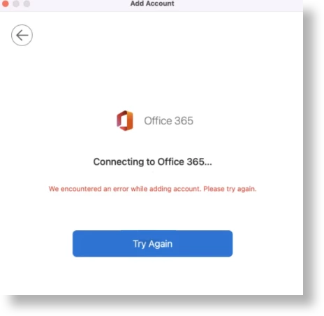

Repair: We encountered an error while adding account. Please try again.
  • November 8, 2024
  • 5 replies
  • 958 views
bwoods
Posting this for anyone experiencing an Office 365 login loop (Usually happens with Outlook). If reverting to legacy Outlook doesn't resolve your issue, run the keychain removal script below. It will restart the device. (The script is sourced from Scott Feit on the MacAdmins Slack channel and has resolved the issue multiple times for me)

@bwoods Is this error occurring when first enrolling a Mac and licensing is via an M365 account instead of a VL? If so, if you launch another office app (e.g. Word) before launching Outlook does Outlook then successfully create the account?
bwoods
  • November 9, 2024
Sometimes I do see this at enrollment and reverting Outlook fixes the issue. Other times I see it for users that have been enrolled for quite awhile. (Other apps are already signed in) Office Reset & reinstallation don't work for those cases. This script is what I use when the loop just won't seem to go away. Hope this helps someone out there. Thank you.
sdagley
  • November 9, 2024
Thanks for the extra details. It sounds like the problem you're seeing with Outlook is not the same one that's been biting me for the past several months.
Jason33
  • November 10, 2024
Outlook has been bad for use since September, but it got much worse in early October. We shut down our express route to Microsoft on Oct 1, and from then on, the standard Outlook no longer wants to show contents of the user inbox or shared mailboxes; for inboxes that do load, new email will come in, but any new email or replies are stuck in the Outbox; activations failing. Like you said, the only resolution for most of these is to switch to Legacy Outlook. I've got a ticket open with Microsoft and their 'suggestion' is for use to whitelist there entire list of URL's, and our security team is not having that.
