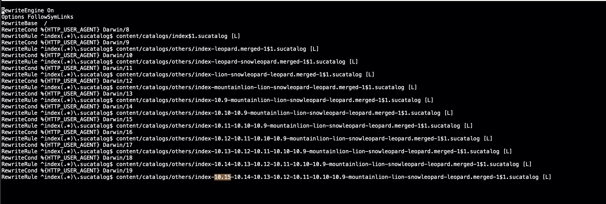

We are using the apache2 method from https://github.com/wdas/reposado/blob/master/docs/URL_rewrites.md
I have cleared the contents of the .htaccess file and re-pasted the entirity of the example to ensure there aren't any typo's etc. Both reposado and margarita have been updated and apache (and the server) restarted.
But still the same message.

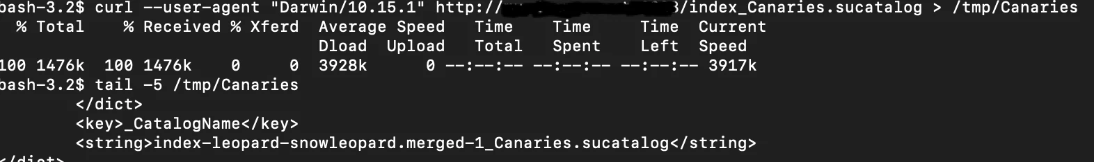

If I browse to the catalog url it opens in the browser and if i run the curl command it gives me what looks like the correct catalog.
There are updates approved in Margarita which are not installed on the mac.

When I worked at my old employer a few months ago the setup did work for me.
In your curl test your are using the wrong user agent though. I don't know if that is the problem here
  • January 29, 2020
^^ this and it is working I just updated
  • January 30, 2020
Thanks for the confirmation, after creating a new branch and running the repo_sync things seem to have resolved themselves and the updates are being served again, not sure what had gone wrong.
