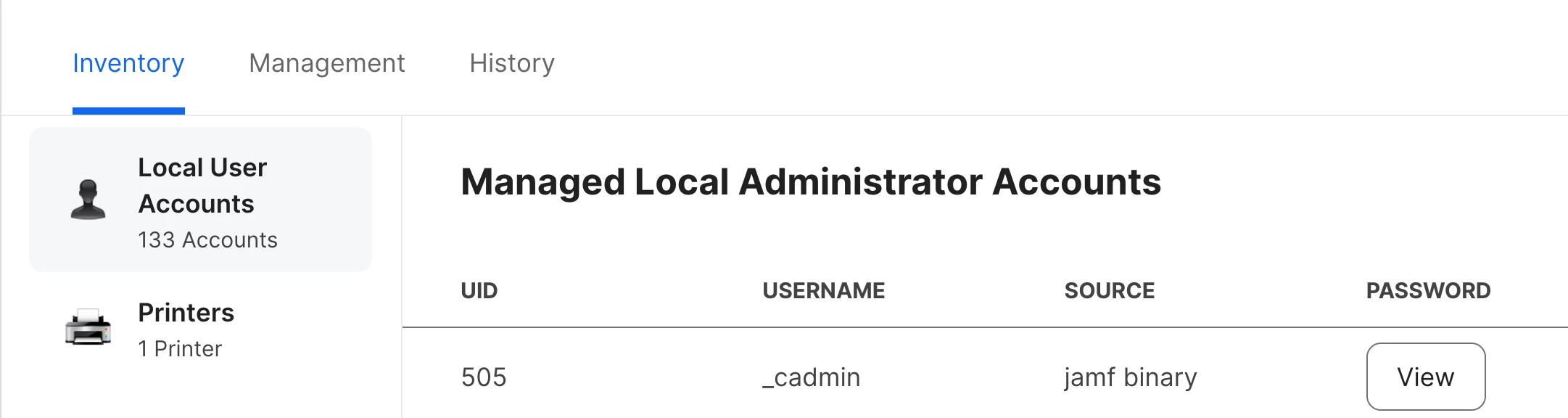

Second way (if you are close to the Mac and can access the Mac)
using LOCAL MAC User from JAMF
Jamf Computer > Device Name > Inventory > Local User Account > Managed Local Administrator Accounts,
User         : _cadmin
Password : Click View will display the passcode
