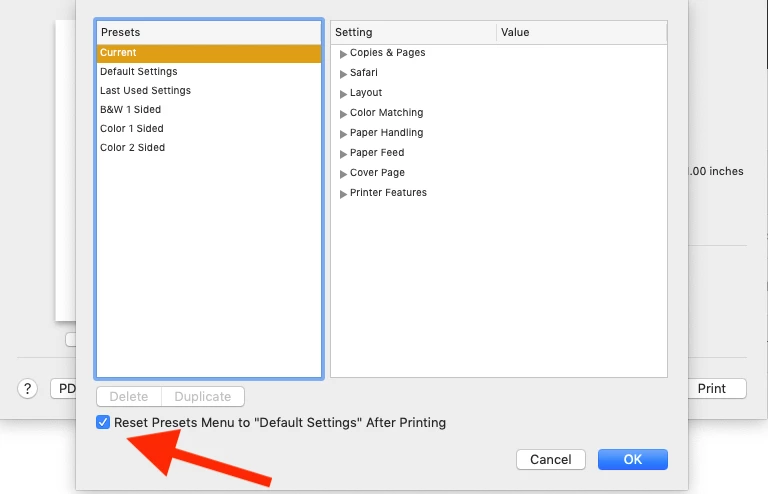

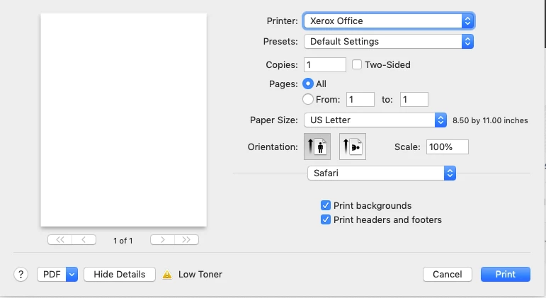

I have been requested to make two sided black and white the default print option for our Xerox Printer. I was able to accomplish this and add some handy presets for the user to select other options like 1 sided and color.

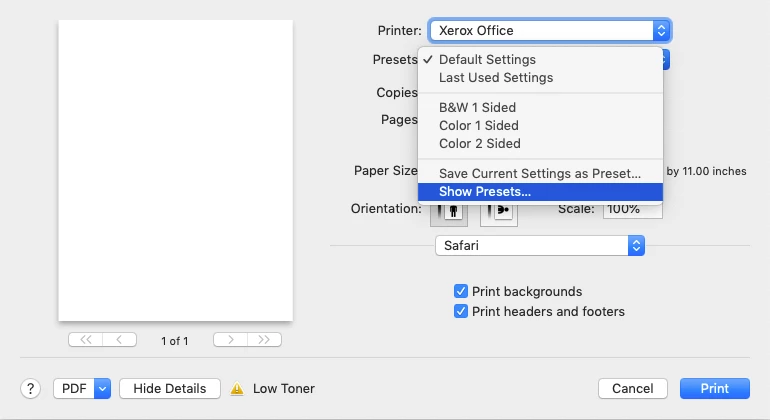

What I have found is unless I open the Show Presets... option and check Reset Presets Menu to "Default Settings" After Printing... Print jobs will use the last preset selected by the user... so if they selected color... the next job will print color as well. Selecting the option above does just what it says and reverts to the default after each print job.
My question is... is there a plist or a command line flag to check this box? I did not see anything in the plist file for the printer or in lpadmin.
Any assitance would be greatly appreciated.

I was able to narrow down where this setting is written.
~/Library/Preferences/org.cups.PrintingPrefs.plist
There is a line - <key>com.apple.print.preset.defaultToStandardPreset</key>
<true/> The Reset Preset Menu to "Default Settings" After Printing is set to <true/> when checked and set to <false/> when unchecked. When changed in the GUI
The default setting of printers is always unchecked.
I tied running the command... defaults write ~/Library/Preferences/org.cups.PrintingPrefs.plist com.apple.print.preset.defaultToStandardPreset true
Which does rewrite the preference file changing boolean <true/> or <false/> depending on my input but it does not change the settings in the GUI. So I am guessing the setting must be cached somewhere or a daemon needs to reload the preference file.
Any guru's out there know a way to get the preference file to reload? I'd like to do everything from the command line.
Thanks in advance,
Ray
