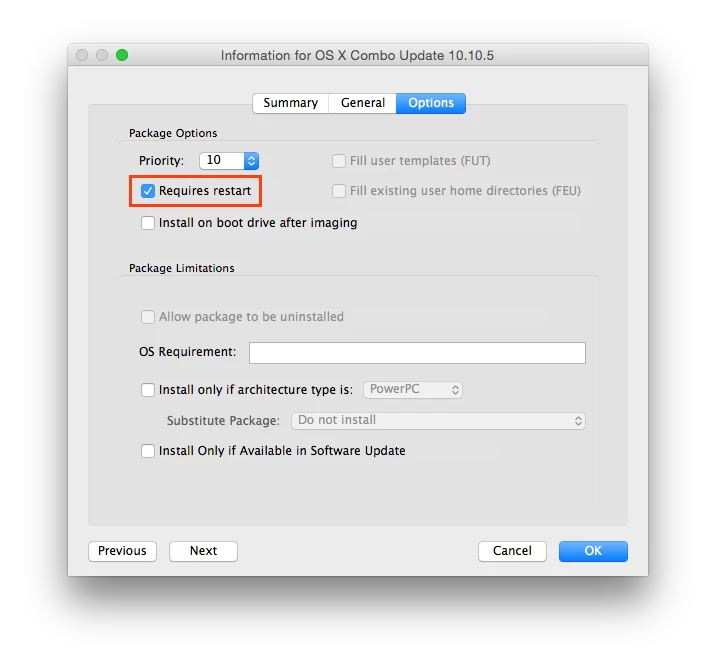

When deploying an OS X Combo Updater via Self Service, how does JSS know that the package requires a restart?
Do we have to set "Requires restart" in the Item Information (metadata) window once the OS X Combo Updater is uploaded?
The reason I ask, I always thought that box would get checked automagically when uploading a PKG that has the "requires reboot" flag checked.
Just had a discussion with a colleague, and we tested and found that we do in fact need to check that box, even if a PKG like an OS X Combo Updater has the "requires reboot" flag set within the PKG.
Did I just answer my own question? It's late, just wanted to see what everyone's experience has been for that option.
