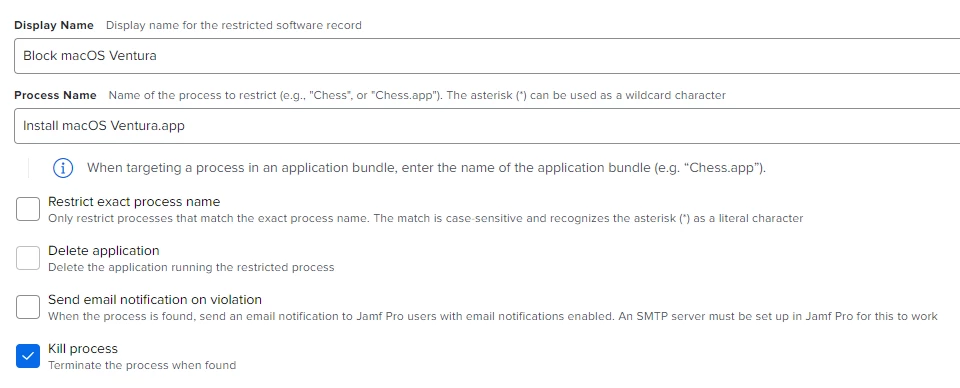

@rtymch_admin  You'll want to utilize the Restricted Software feature as depicted below
(Jamf Dashboard -> Computers Tab -> Restricted Software -> +New)

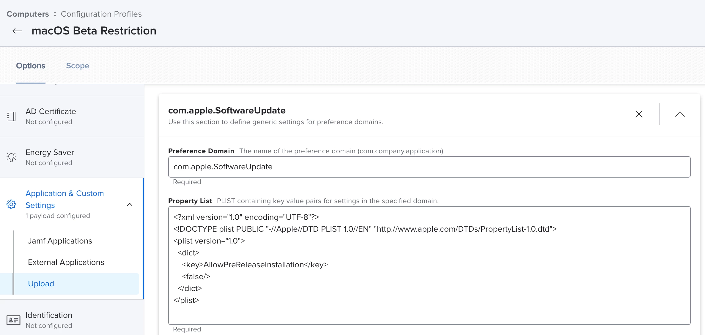

@rtymch_admin You can block betas by using an Application & Custom Settings payload in a Configuration Profile to deploy the following .plist to the com.apple.SoftwareUpdate domain:
<plist version="1.0">
  <dict>
    <key>AllowPreReleaseInstallation</key>
    <false/>
  </dict>
</plist>

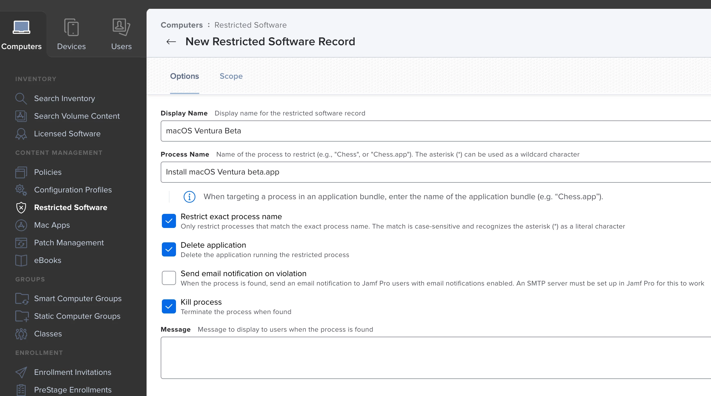

As for blocking the macOS Ventura installer there is a problem with the Restricted Software method @Hugonaut presents in that for users on macOS Monterey 12.3 or higher the macOS Ventura update will apparently be done as a delta update via the Software Update process instead of requiring the full app installer to run so you need the update deferral Configuration Profile to block that plus the Restricted Software configurations to block users who try downloading the full installer.

@sdagley do you mind please adding a screenshot of how you blocked the Ventura Beta version?
Couple weeks late to the party but in case you still need it, it should look like this.

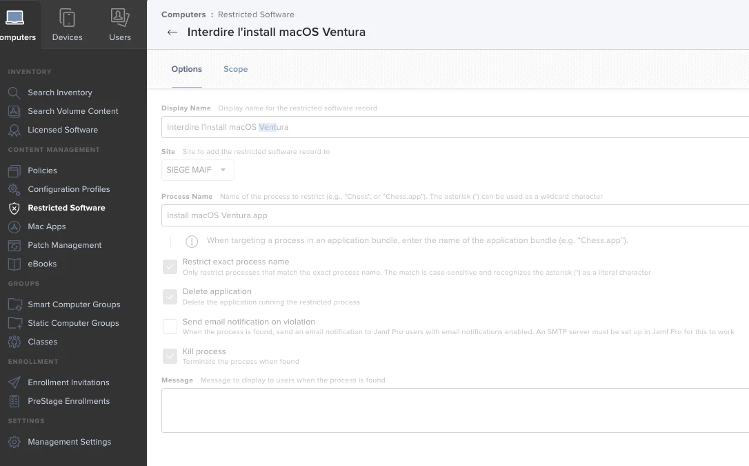

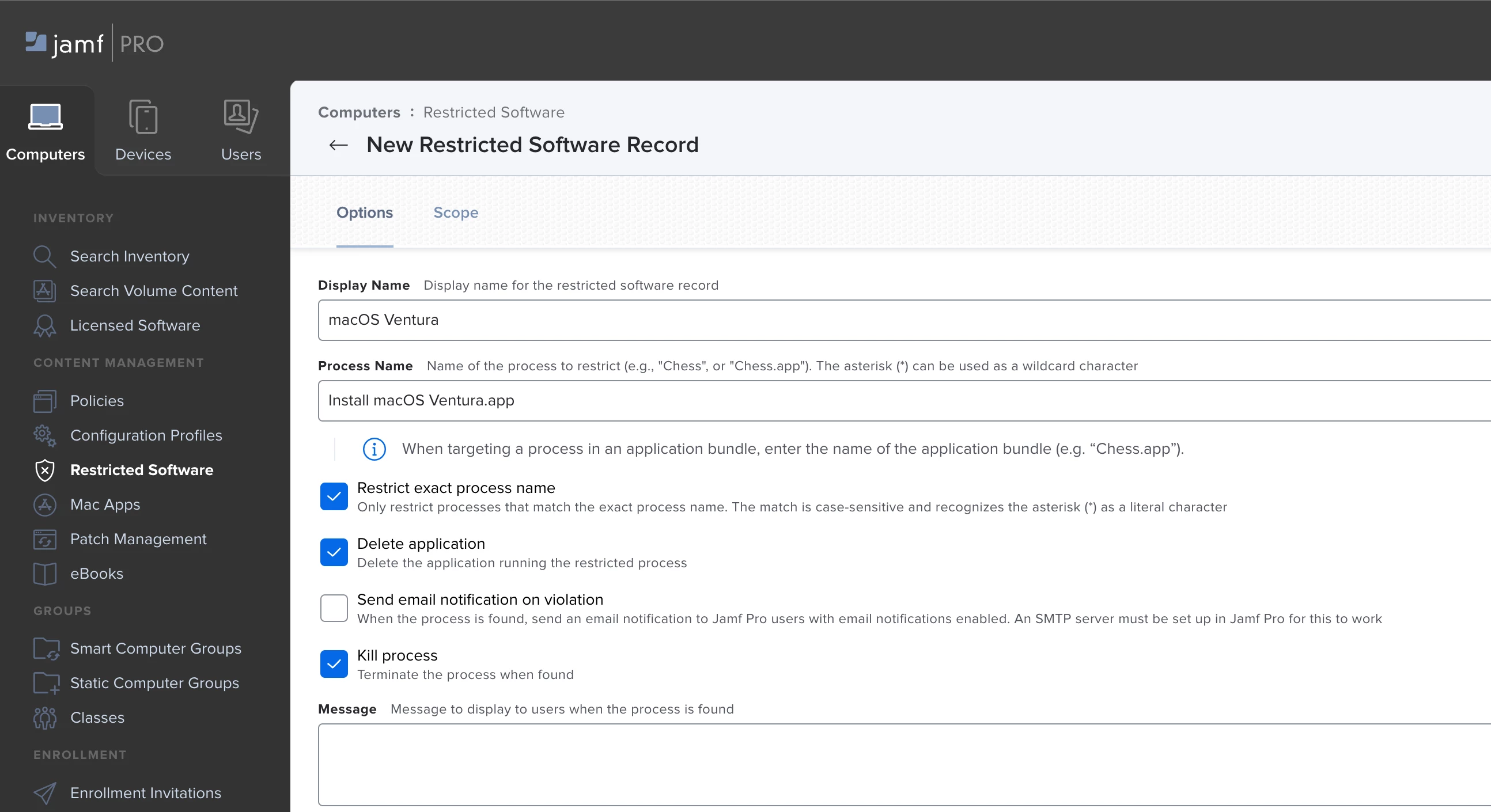

@Euwanh I would start with a Restricted Software policy for the process name InstallAssistant so that any user who gets the full installer can't run it via the GUI (you can still run the erase-install script via Jamf Pro to drive the upgrade process with that restriction in place).

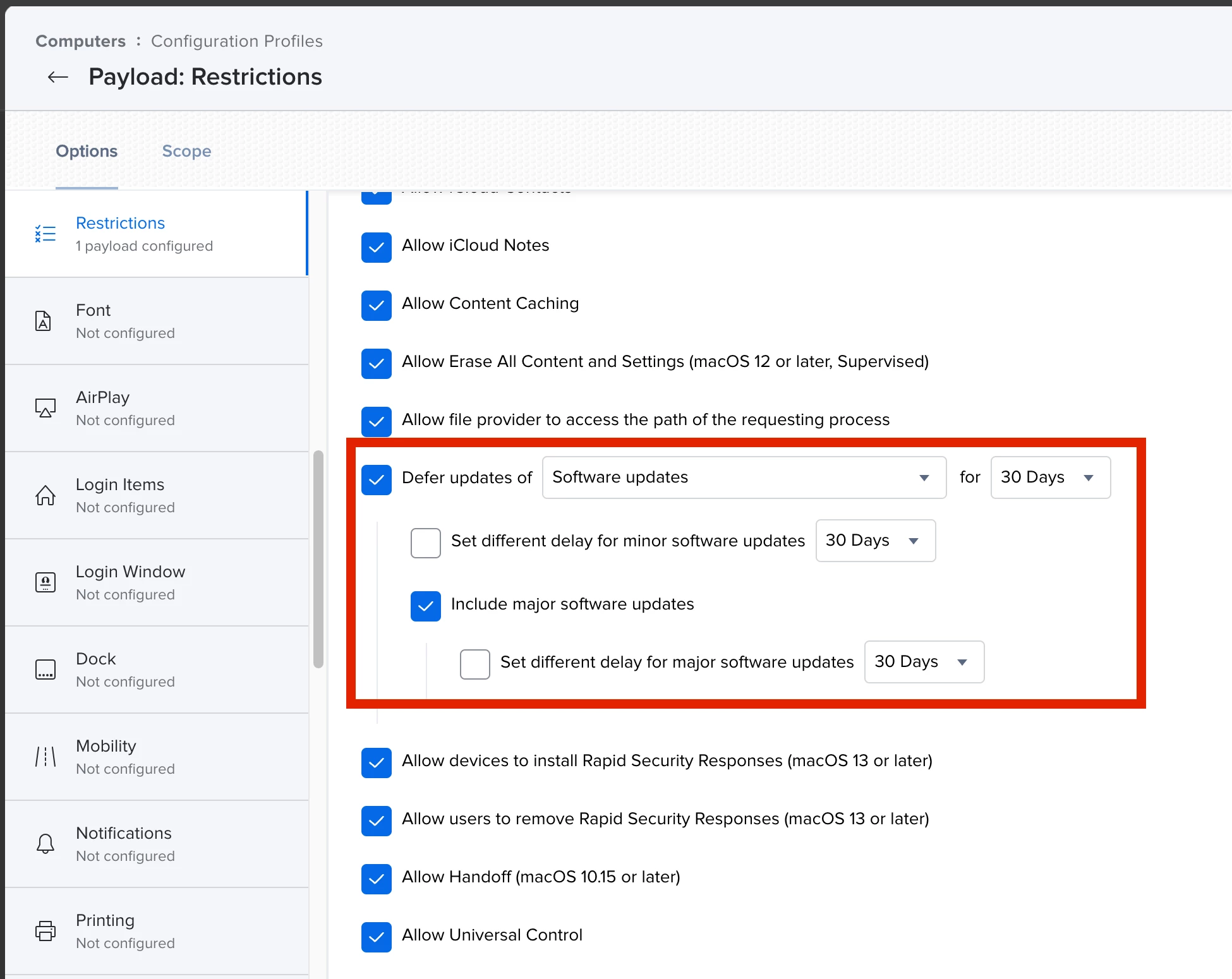

@Eskobar
macOS Ventura Update is seen as a Minor Update on macOS 12.3 - 12.6 ~ https://support.apple.com/en-lamr/HT213471
You need to create a Configuration Profile with the Restrictions Payload. Under "Functionality" Tab of Restrictions Payload, you need to check "Defer updates of Software Updates for 30 Days" (Or whatever you deem necessary, there's a few options)
