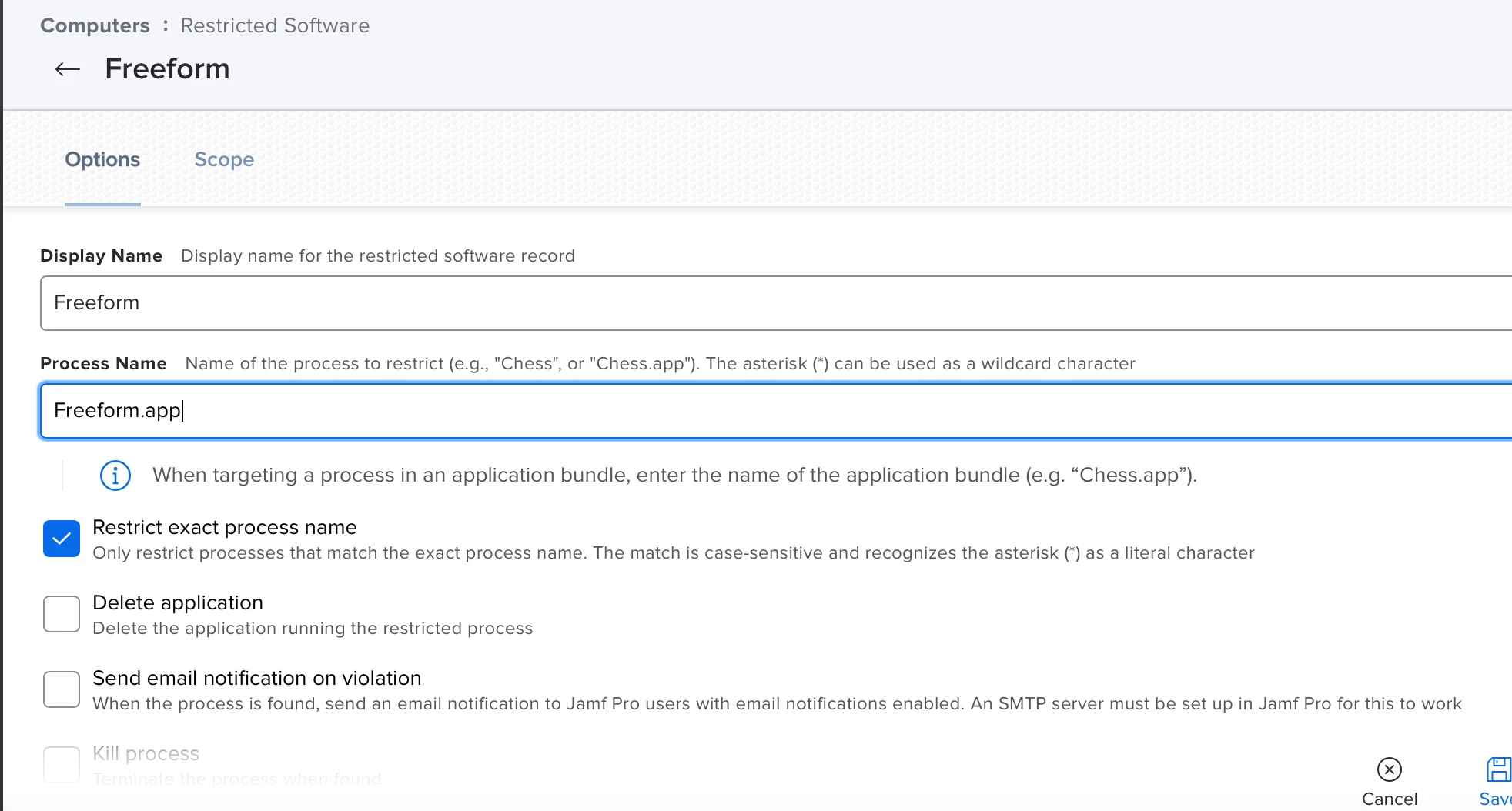

I'm trying to restrict access to Freeform on our K12 lab iMacs using Restricted Software payload in Jamf Pro. I was able to block the app on iPads in Jamf School using com.apple.freeform but that has not worked on Jamf Pro.
I tried to block Freeform.app but have not had success. Anyone able to block this app from appearing?
Best answer by AJPinto
I got it to restrict without issues. You dont have the kill process box checked, so I dont think you are telling JAMF to do anything if the application runs. To test faster, you can run sudo jamf manage which will cause restrictions to update immediately.
1 reply
AJPinto
  • January 26, 2023
