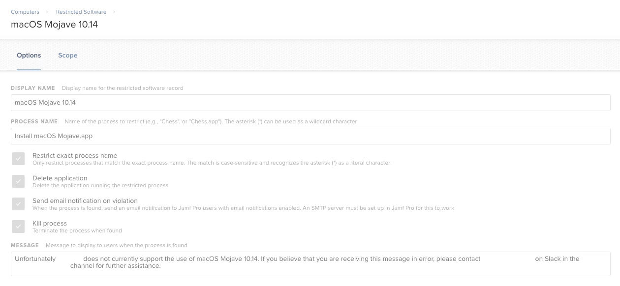

Greetings, all! We're using "Restricted Software" to prevent unwanted in-place upgrades to Mojave when it is released next week. Since this'll be in testing for a few weeks or so before our organization approves the use of the new macOS, I wanted to use this restriction workflow. I just wanted to take a moment and verify the accuracy of the process name that I am using. What're your thoughts? Is this a good educated guess based on previous naming conventions for macOS installers that Apple has used?

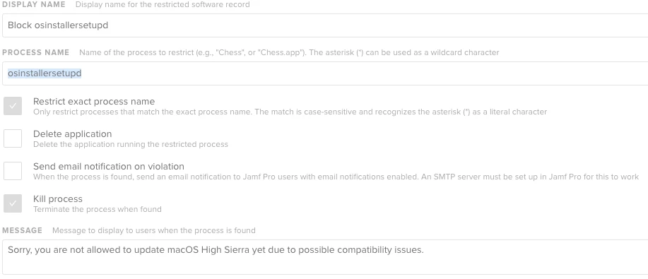

Hi @sepiemoini
Seems fine to me, to be sure you can also restrict the osinstallersetupd process.
See screenshot.
EDIT:
You can also add another one, InstallAssistant as well.
Because if they rename the app to Install macOS Mojave for fun.app it would still run.

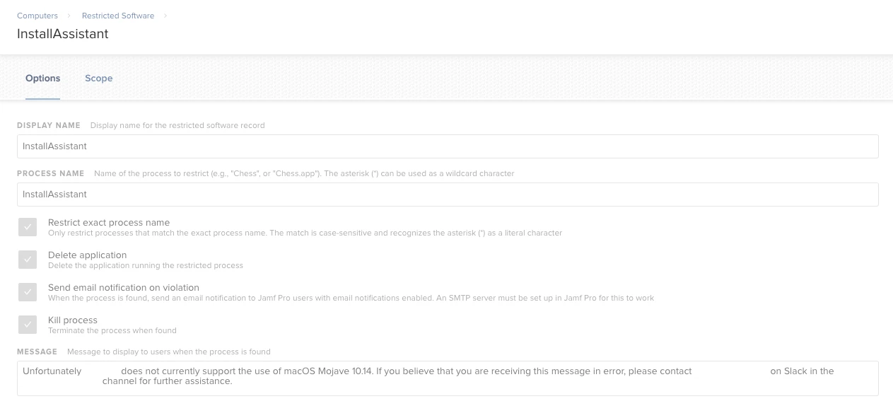

I block InstallAssistant, which works for all recent OS versions, and, I presume, should also work with Mojave, but we'll know for sure once it's released.

Do you mind providing a screen capture of your InstallAssistant restriction for clarity, @mm2270?

This is what I've got, @mm2270:

mm2270
  • September 18, 2018
@sepiemoini I'm not enabling the Delete application or Send email notification options.
The first one because, using InstallAssistant, it won't actually delete the "Install macOS Mojave.app" It will only delete the InstallAssistant binary and leave the rest of the app in place, albeit broken since it can't run with a double click anymore after that. There's nothing wrong with doing that, but if the hope was to remove the whole application, that isn't going to do it.
You could use 2 restrictions. One that blocks InstallAssistant and another that looks for the entire "Install macOS Mojave.app" bundle, with the option to delete the application enabled, to cover your bases.
The second one isn't enabled just out of preference. I don't really care to be spammed by my Jamf server about these violations. But that's personal preference only. Nothing functionally wrong with turning that on.
Lastly, I'm using a different display name, like "Block macOS installs". But that's also personal preference.
