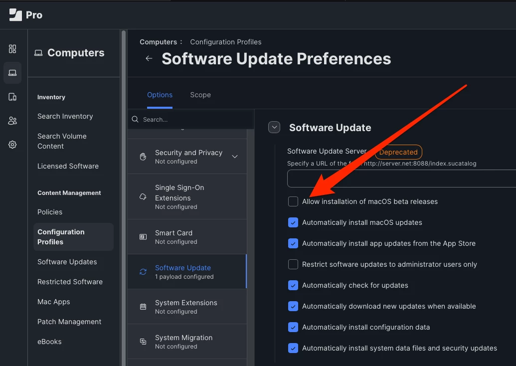

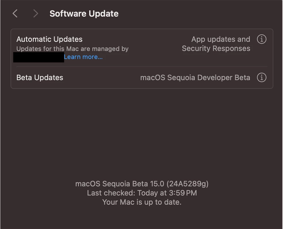

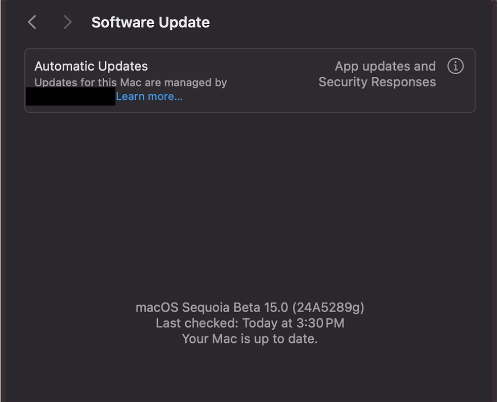

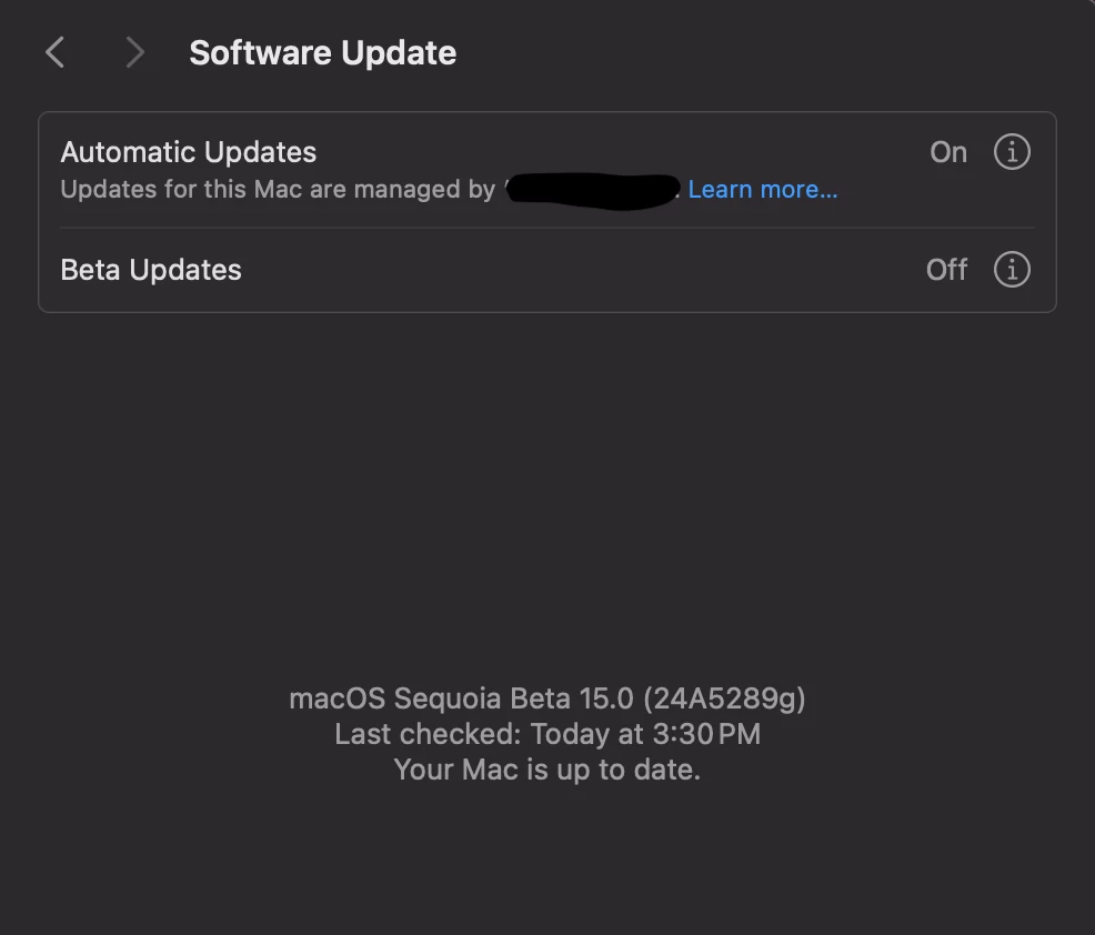

I just spent a bit of time on this today and confirmed a few things with Jamf. There is no way to actually block macOS Betas through Software Update. You can defer all updates for up to 90 days which will prevent users from being able to install it through Software Update. Using Restricted Software will only restrict it from being installed if the package is downloaded from the web. For instance, if I download the beta from Apple's website, then Restricted Software will prevent the installation.
Here's where @mvu's idea comes into play. While yes you can use the configuration update to do this, it doesn't do what we want it to do. I've tested this myself and have come up with how this configuration profile actually works by trial and error. So, as long as the user has Beta Updates turned off in Software Update, this configuration profile will hide the Beta Updates field all together which will prevent the user from accessing Beta Updates through Software Update. This does not prevent the user from installing a Beta if they download it from the web. That's where Restricted Software comes into play.
If a user has Beta Updates turned on and the configuration profile is added to their computer, the configuration profile does nothing and does not prevent the user from installing Betas through Software Update. The Beta Updates field remains visible even though the configuration profile is in place. If that same user turns off Beta Updates and refreshes System Settings, then yes, the configuration profile will hide the Beta Updates field.
