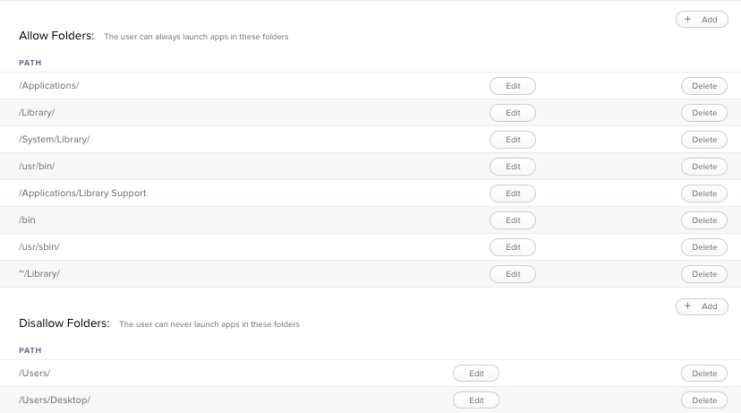

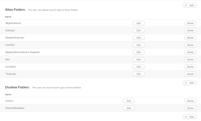

Hey all.
I have two or more questions about allowing & Disallowing certain locations to launch an application from as well as a coding question.
I added several whitelisted items, as seen below:
It seems to be working with an Hey you can't open this message. But then the below image shows up allowing them to select allow, which opens a new popup asking for the admin password.
Well these users are admins of their device, so basically I think I am chasing my tail here as they can approve what they can launch. Is that correct?
Another question I have is some allow/disallow path names are written /Applications/, whereas others are written ~ /Applications/... so as a non-coder what is the difference?

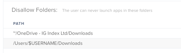

  • Nov 21, 2019 12:55 PM UTC
I have been trying to do this myself after I found that several of our users are running their development environment from within the downloads folder which is also being scanned by the antivirus and slowing down the computer.
I found that it is possible to use either the ~ or $USERNAME to block the downloads path as below
The issue which I found is ANY application which has been used in the ~/Downloads folder will NOT be blocked once the profile has been installed. Any new application copied into the ~/Downloads folder WILL be blocked. If you copy a working application from the ~/Downloads folder then copy the same application back into the ~/Downloads folder it will NOW be blocked.
So far I have not worked out how to reset the application history. I have already reset the gatekeeper database with
sudo spctl --reset-default
and this had no effect. So I am assuming that I may have to reset the spotlight database to blocked the applications from running after the profile deployment.

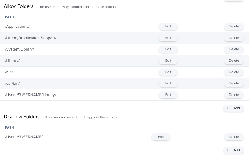

  • Jan 16, 2020 12:32 AM UTC

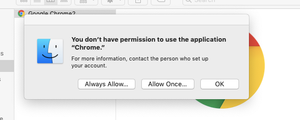

@rhooper Were you ever able to figure out your issue? I'm trying to stop my users from running applications from the downloads folder and desktop. I copied your allowed folders and disallowed folders path but I'm running in to the same issue every time I launch chrome.
Does anyone have any other paths that should be added so that this error stops occurring? Please let me know. Thanks for your help in advance!
@rhooper I ran into the exact same issue. Whats the point if a user can just override?
Bit puzzled. When I add either:
- /Users/$USERNAME/Library
- ~/Library
I find that users can launch apps from the desktop, when I removed those 2 entries they cant.
Bug?
  • Sep 1, 2020 3:35 AM UTC
@vanschip-gerard
Is it possible your users have iCloud documents enabled? That puts the user's Desktop folder into the actual path /Users/$Username/Library/Mobile Documents/Desktop

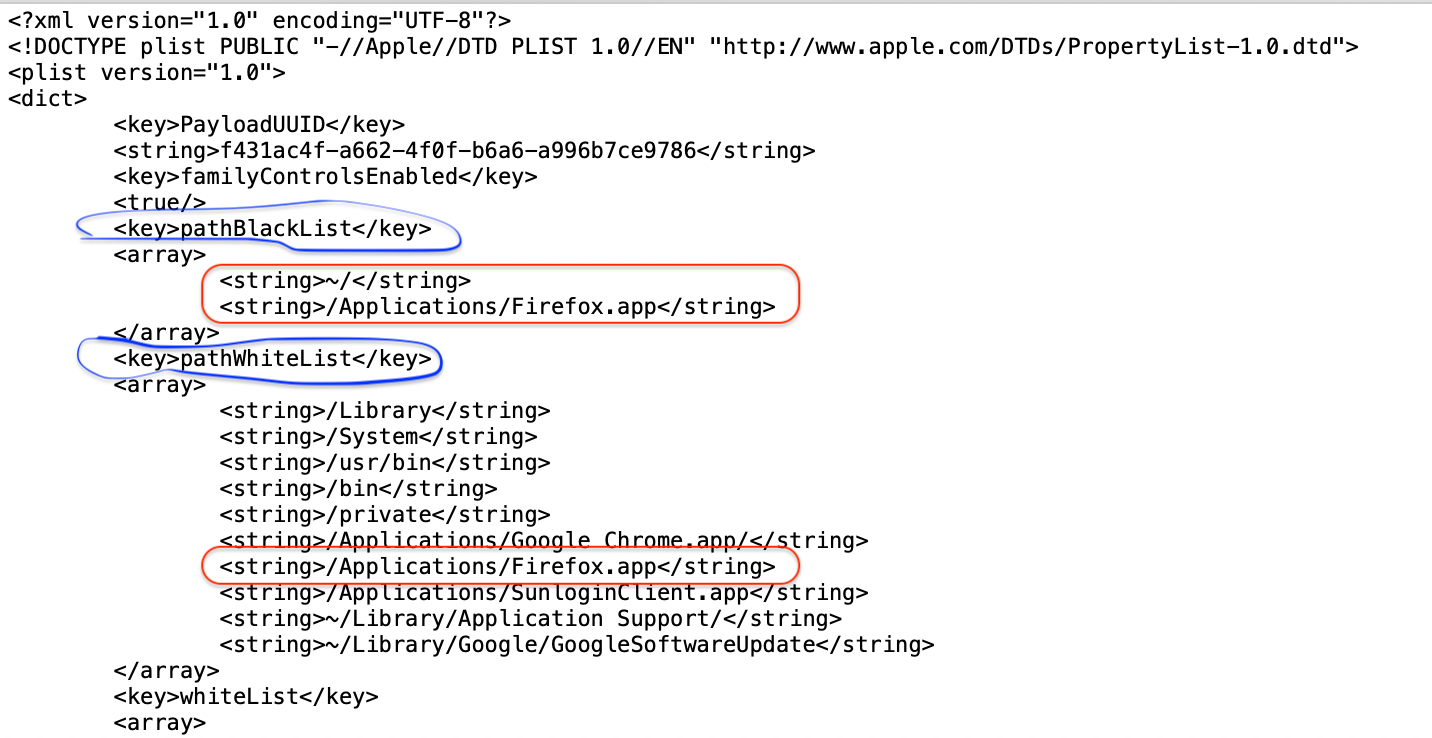

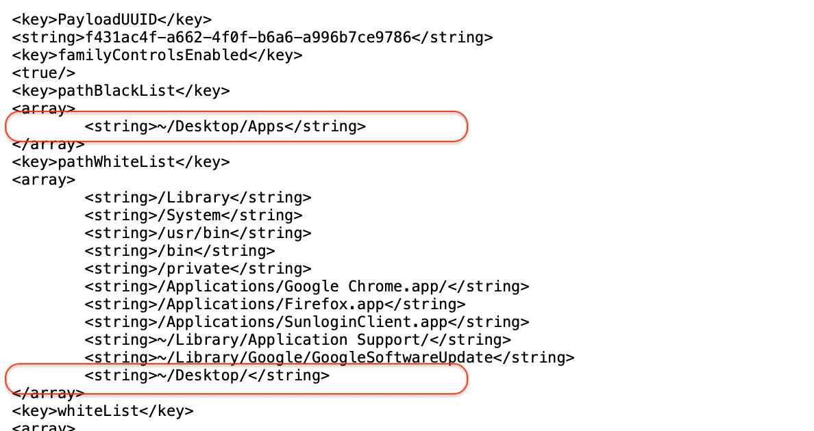

@msalvaleon According the key order of the Managed Preferences com.apple.applicationaccess.new.plist, I think the system check the disallow folder list first when you try to run the apps, that means if you have disallow folder path /A and allow folder /A/B, and try to run /A/B/c.app, the system will kill c.app. So if you have child folders need to be allowed, you shouldn't add the parent folder to the disallow folders list.
in the first screenshot, I have Firefox app in disallow and allow folder, and ~/ in disallow folder, and ~/Library/Google in allow folder list. the result is I don't have permission to run Firefox and Google updated.
in the second screenshot, I created an Apps folder on Desktop and copy Firefox to Apps folder, add Apps folder to disallow folder list and add parent folder Desktop to allow folder, the result is Firefox is been killed and other apps on Desktop are not.
And I tried to change order of the pathBlackList and pathWhiteList use PlistEdit, the key pathBlackList still keep on the top in the plist file.
