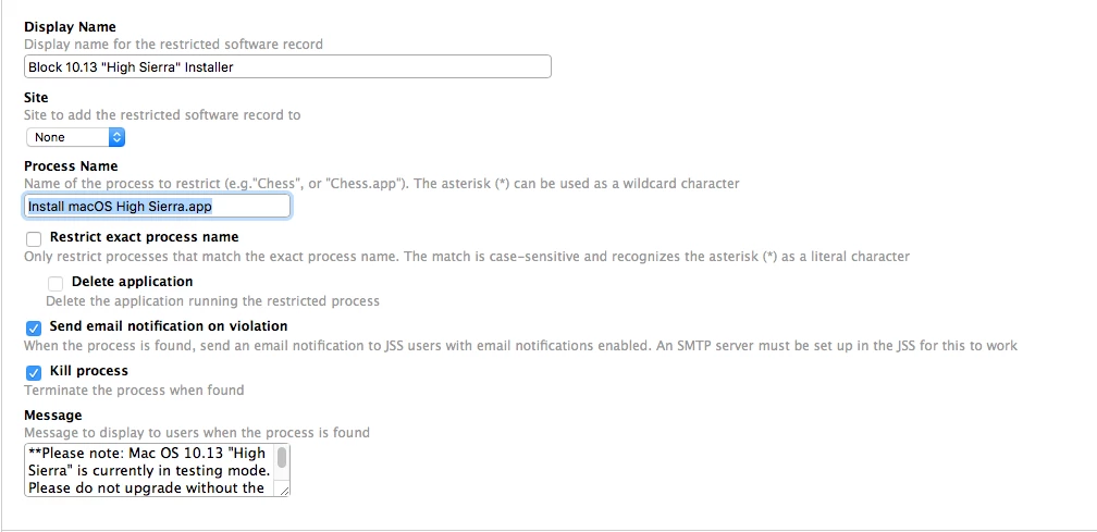

So a while back I setup restrictions on three different processes to prevent our users from installing High Sierra yet I have a machine in JAMF I use for testing and had it blocked as well yet it installed. Am I missing something? The ones I restricted are Install macOS, I later went back and added to that High Sierra at the end. I also restricted osinstallersetupd & high sierra. Any input as to why it failed to block these actions? Thanks, Adam

Working well in testing here set up as follows:

Are you using wildcards or forcing it to match the string exactly? I restrict "Install macOS High Sierra.app" with "Restrict exact process name" checked but I understand that someone can rename their installer if they want to get around it. It's a more casual block because I don't want to start blocking all macOS installers.
Forum|alt.badge.img+15
  • September 25, 2017
I will give that a try. Thank you!

We can confirm the [ ] Restrict exact process name box needs to be off, else the exact process name is not blocked.

I am wondering if this setup actually kills a process, or merely an app name when launched?
I setup a Restriction like this:
Process Name:
*High Sierra*
Do NOT restrict exact process name.
In testing, it works great - with the release and the betas. Yet, you could still run the "Sierra" installer OK.
However, if you change the name of the installer to omit "High Sierra", the installers (release and beta) will launch and run.
Looking at Activity Monitor while doing this, I see the exact process "Install macOS High Sierra" there, but not being quit.
So, to me, it's looking for a running app with the name, and killing it, not the process itself. Hoping I am able to make sense here...?

I modified my existing Sierra policy for High Sierra. This is working for me.
Install macOS High Sierra*
Restrict Exact Process Name is unchecked.

Process Name: High Sierra
Restrict Exact Process Name = Disabled
...is working for me thus far in my limited testing.
