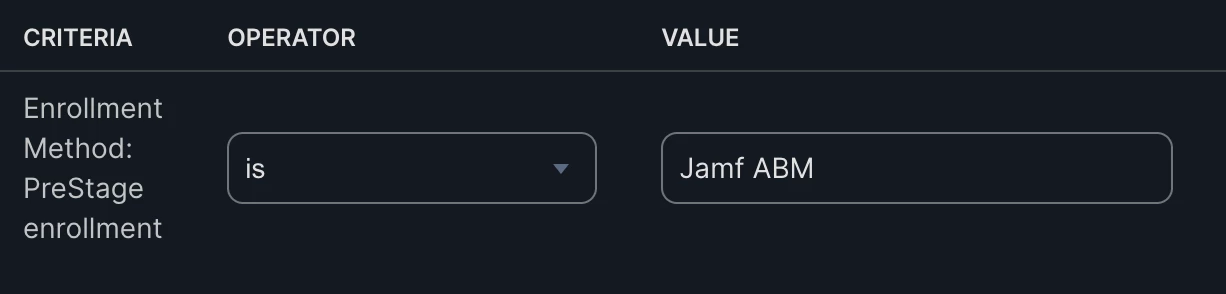

Does anyone have suggestions how to maintain iPads in the Return to Service app scope after it is run? The iPads are dropped from static groups, and I can't think of a smart group that will retain the iPad after it is erased (other than all iPads and I don't want scope this to all iPads).

You could use the PreStage as criteria for a Smart Group. The criteria is "Enrollment Method: PreStage enrollment" and then you choose the name of the PreStage. Only word of caution is that if the PreStage gets deleted at a later date, all of the devices enrolled by that PreStage will fall out of the Smart Group. I think that happens if the PreStage is renamed as well, but am not 100% on that.
Aside from that, finding some criteria that is unique to the devices would help as well. If you're requiring a sign in during the enrollment, finding an attribute from your directory service that you could key off of might work as well.
