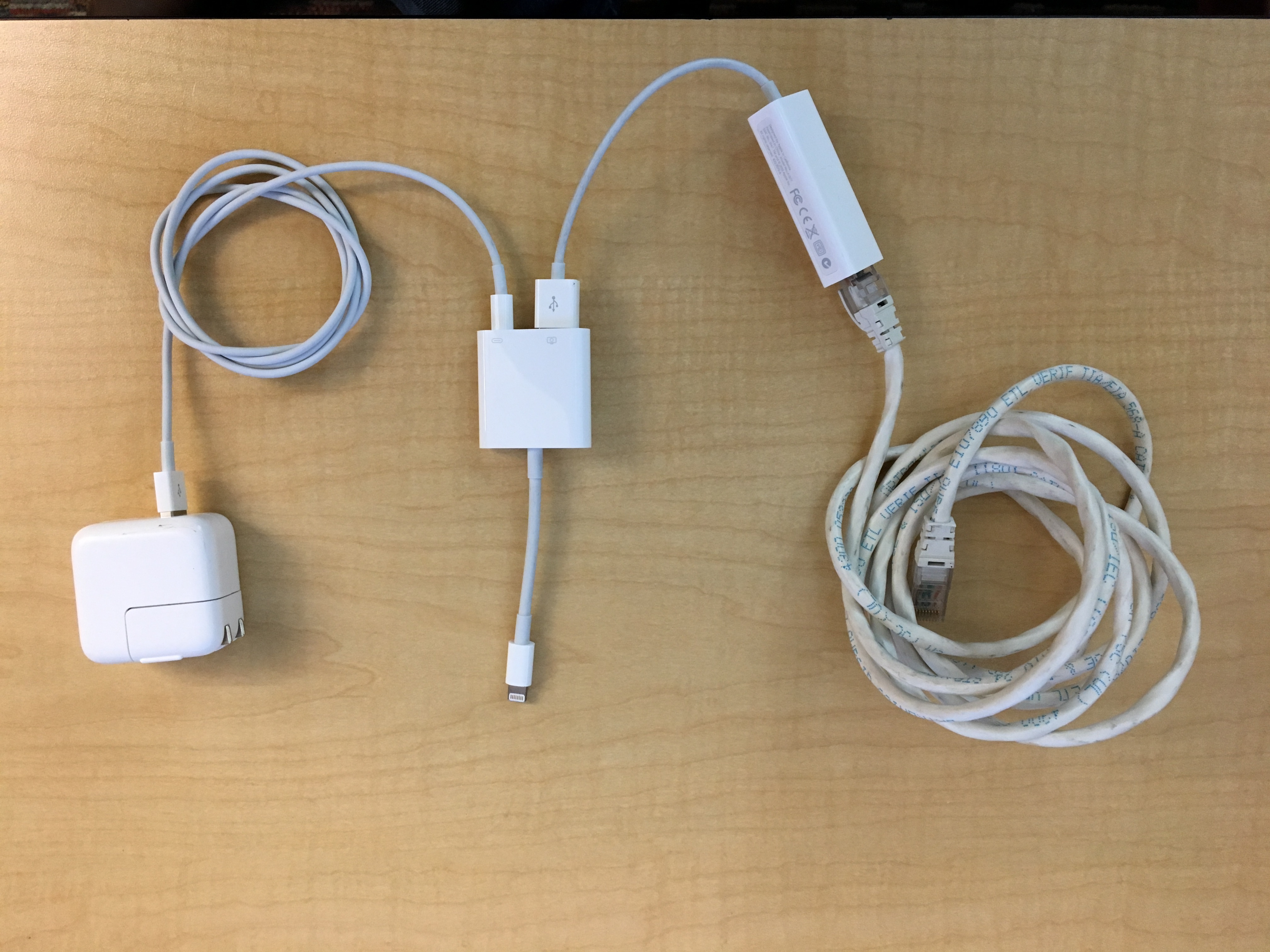

This is what mine looks like:
  • Lightning to USB Camera Adapter plugs into the iPad.
  • The lightning port on the adapter plugs into a 12w Charger.
  • The USB port on the adapter plugs into a USB to Ethernet adapter.
  • The Ethernet adapter plugs into a network cable.
This works and simple to store.

For the 30-pin connection, my setup is the same path but different adapters. In fact, it's too embarrassing to share a photo but it works.

@BrentBuena has it right. That's what we use and it has worked great for us. I think I used it for the exact purpose you were looking to use it for.
