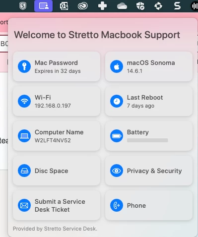

This is what I have set up.

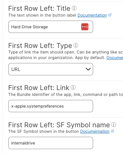

@wakco11 This is my Config for showing Hard Drive Storage and I get this error. Did I put this in wrong?

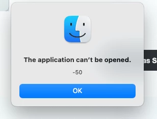

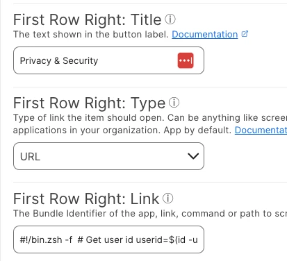

This is my set up for Privacy & Security using your latest script. Error pops up. Is this correct?

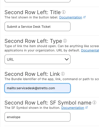

This is my Submit a ticket config. No error pops up - it just doesn't do anything when you click on it.

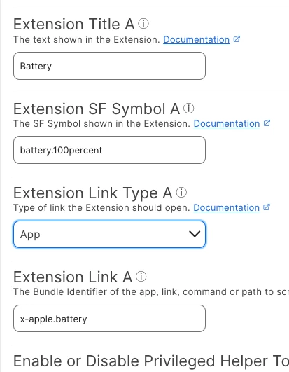

As there are only 2 custom InfoItems, and you only have 1 built-in InfoItem you can use (Storage), requiring the rest to be custom, I'd suggest first, changing the order, so that the first two can be InfoItems, and the other two can be two buttons in a single row. I'd put the Battery and Storage in the two InfoItems, with scripts to provide the Battery information and using the built-in InfoItem for Storage. Then the mail link should work for the submit ticket buttons, leaving finding a way to open the Privacy & Security preference pane, and thanks to a System Preferences/Settings extension called SwiftDefaultApps (not required, it's just how I found the URL option) I found that using x-apple.systempreferences: as the URL, System Settings would open to the Privacy & Security pane.
This is my battery config. Shows nothing. See previous screen shot of my GUI on desktop.
The script should actually be an executable script placed on the computer somewhere it can run, and the "Link should be the path to the script.
This works. You have to be logged into your Outlook in order for the link to pop open.
mailto: links will require that a mail client is set up to receive the mailto: link. That could be Mail, Outlook, Thunderbird, or other email client. There are ways to configure a web browser to receive mailto links as well.
This works - must be in the first 6 top Tiles.

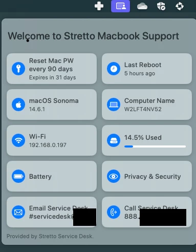

  • Aug 21, 2024 11:59 PM UTC
My updated Support App on a Mac:
