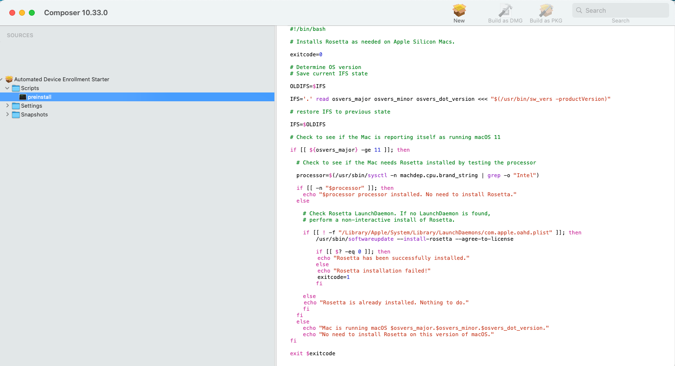

FWIW this is our current method. I have a Policy named "0 - Install Rosetta 2" so that it runs first when a computer goes through PreStage:
 Then this from the Der Flounder script:
#!/bin/bash # Installs Rosetta as needed on Apple Silicon Macs. exitcode=0 # Determine OS version # Save current IFS state OLDIFS=$IFS IFS='.' read osvers_major osvers_minor osvers_dot_version <<< "$(/usr/bin/sw_vers -productVersion)" # restore IFS to previous state IFS=$OLDIFS # Check to see if the Mac is reporting itself as running macOS 11 if [[ ${osvers_major} -ge 11 ]]; then # Check to see if the Mac needs Rosetta installed by testing the processor processor=$(/usr/sbin/sysctl -n machdep.cpu.brand_string | grep -o "Intel") if [[ -n "$processor" ]]; then echo "$processor processor installed. No need to install Rosetta." else # Check Rosetta LaunchDaemon. If no LaunchDaemon is found, # perform a non-interactive install of Rosetta. if [[ ! -f "/Library/Apple/System/Library/LaunchDaemons/com.apple.oahd.plist" ]]; then /usr/sbin/softwareupdate --install-rosetta --agree-to-license if [[ $? -eq 0 ]]; then echo "Rosetta has been successfully installed." else echo "Rosetta installation failed!" exitcode=1 fi else echo "Rosetta is already installed. Nothing to do." fi fi else echo "Mac is running macOS $osvers_major.$osvers_minor.$osvers_dot_version." echo "No need to install Rosetta on this version of macOS." fi exit $exitcode

I'm using derflounder's script in a blank package with a preinstall script.
