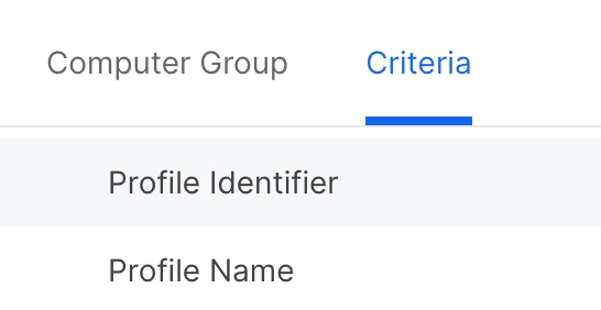

Ashok_A
  • May 2, 2024 11:00 AM UTC
While the use case appears unclear, the solution would be creating a smart computer group with the Profile name/identifier. This group automatically calculates when the profile is installed on Mac computers and is then used for policy scoping
