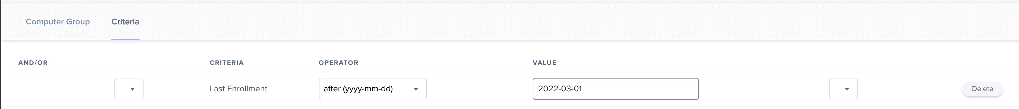

@kbednarto a similar effect of what @sdagley said - you can always create a smart computer group for recently enrolled devices. Then scope that group to the policies with a trigger of Enrollment, Check-in, etc
