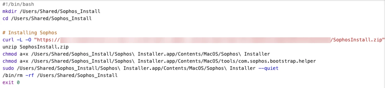

I am trying to install sophos through JAMF School and used their script.
The script it working fine when running it on the mac as sudo, but when i try pushing it through JAMF, nothing happens.
This makes me wonder if i am missing something, i seem to be unable to make the app run as an administrator/sudo user.
Can anyone help?

Jay-payglocal
  • May 29, 2026 10:38 AM UTC
Go through these in order:
  1. Remove all sudo usage
  2. Add logging to script
  3. Use absolute paths
  4. Verify JAMF policy execution
  5. Check /var/log/jamf.log
  6. Confirm Sophos installer doesn't need UI
  7. Try PKG deployment instead of script

Is this the script you are using, and are you running macOS Tahoe?
Yes, it is. And yes, we are running the newest OS (Tahoe i think).

I’d remove the cd and put the full path in the downloader...actually my script just looking at it would be something similar to this on a very high level:
#/bin/bash
# Variables (edit this)
download=”urlGoesHere”
filePath="/Users/Shared/Sophos_Install"
name=”SophosInstall”
# Download Sophos
curl -L "${download}" --output "$filePath"/"${name}".zip
# Unzip
unzip "$filePath"/"${name}".zip
# Perms edit
chmod atx "$filePath"/Sophos\ Installer.app/Contents/MacOS/Sophos\ Installer
chmod atx "$filePath"/Sophos\ Installer.app/Contents/MacOS/tools/com.sophos.bootstrap.helper
# Install
"$filePath"/Sophos\ Installer.app/Contents/MacOS/Sophos\ Installer --quiet
# Cleanup
/bin/rm -rf "$filePath"/
# Check install
sophosInstalled=$( launchctl list | grep -I sophos )
if [[ $sophosInstall == "0" ]]
then echo "Sophos Installed Successfully"
else echo "Sophos did not install successfully. Please retry"
exit 1
Of course the check at the end will likely need to be altered...I just took a stab at it.

I am unable to get this working. Thing is; when i run the script on the machine manually, it does function as intended.
Within JAMF School i am unable to set any parameters like run as system. Nor am i able to set script execution policies anymore within JAMF School.
I did add the provided profiles that Sophos added to their guide.
What else could i try? Maybe i could create a PKG file or something?

Alright, looks like the issue is resolved by using some tips here and AI.
One issue was logging wasnt working and i was copying the script from windows which added some weird errors to JAMF.
Recopied and added the script through my macbook and it actually works.
For anyone interested, here is the final script used:
