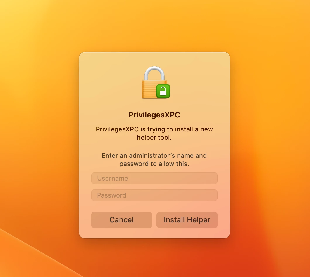

Hi,
I'm preparing deployment of the admin-by-request tool Privileges (https://github.com/SAP/macOS-enterprise-privileges), but I've run into a snag when I try to install it via Jamf.
So, the package that I've made has the .app, the LaunchDaemon and the PrivilegedHelperTool, all according to the documentation, and they all install fine. But when I run it the first time, I get the following prompt asking me for adminstrator credentials to install the PrivilegedHelperTool again:
If I enter them, it works as expected, but the problem is that I want a standard user to be able to install this without entering any admin credentials.
Has anyone encountered this problem? I don't understand why it wants to install it when I've already pre-installed it via my package.
Best answer by sdagley
@samuellarsson Here's a guide on creating a Privileges installer package using Composer that will set up the helper tool during installation: https://travellingtechguy.blog/sap-privileges-app/

sdagley
  • March 8, 2023
  • March 8, 2023
I use Rich Trouton's AutoPkg recipe found here.  It's also in the JAMF App Catalog in the Mac Apps Section.
  • March 9, 2023
That was exactly what I was looking for, thank you!
