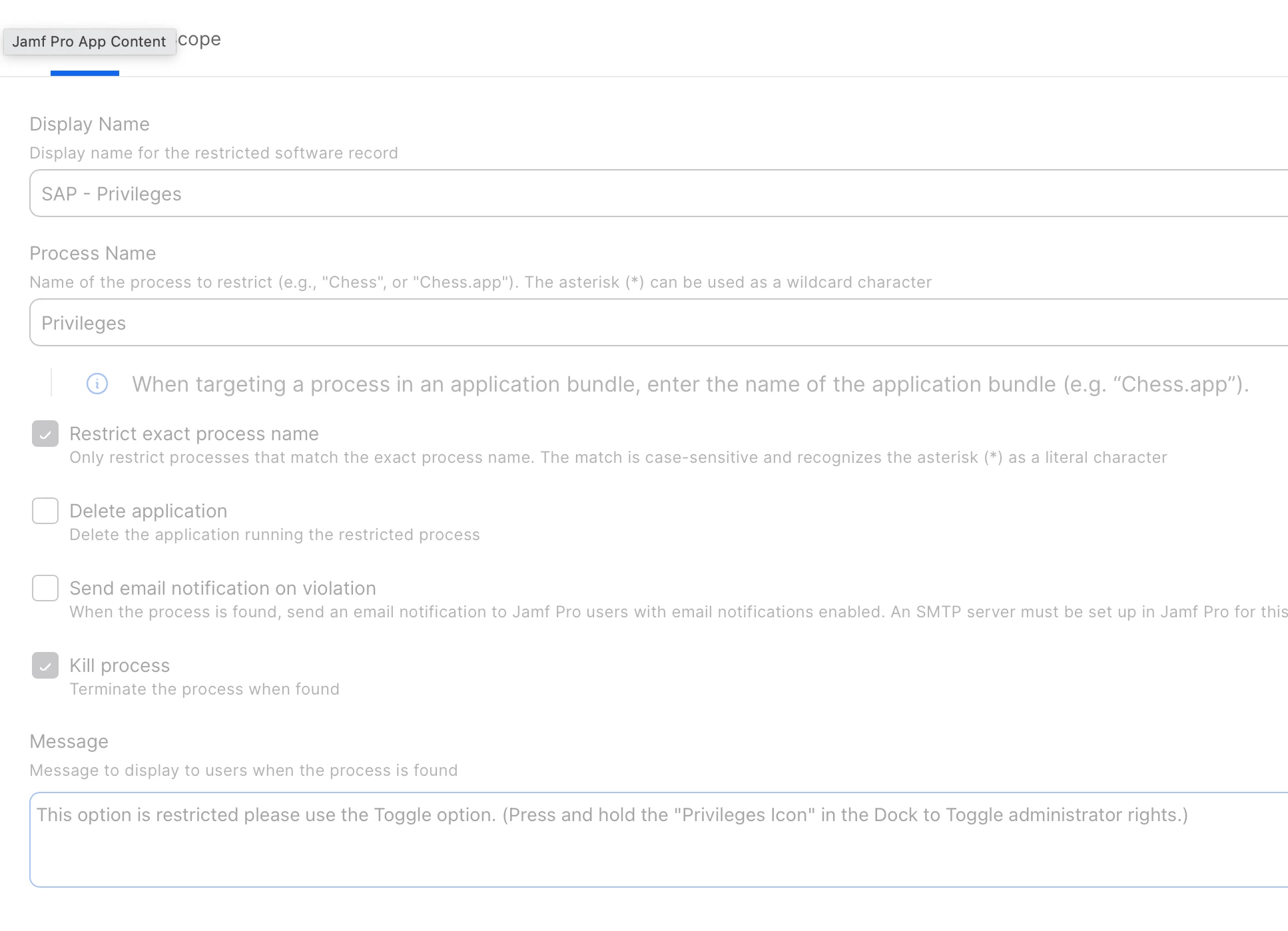

Best answer by PE14_2
From rtrouton @rtrouton thanks
I’ve noticed a number of folks having problems with manually packaging Privileges. I recommend using AutoPkg to build an installer for it: https://derflounder.wordpress.com/2022/04/20/building-a-privileges-installer-package-using-autopkg/
This download option with Rich describes with Autopkg works for me. Also in Jamf at Restricted Software I add this option :
From Graham Pugh
If you set the Process Name to “Privileges” rather than “Privileges.app”, the toggle option is still allowed, but the double-click option is restricted. Neat!
