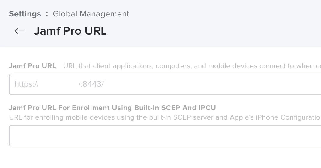

  • August 17, 2020
what I did to fix my issue was clear the area that uses SCEP and IPCU and it worked fine
