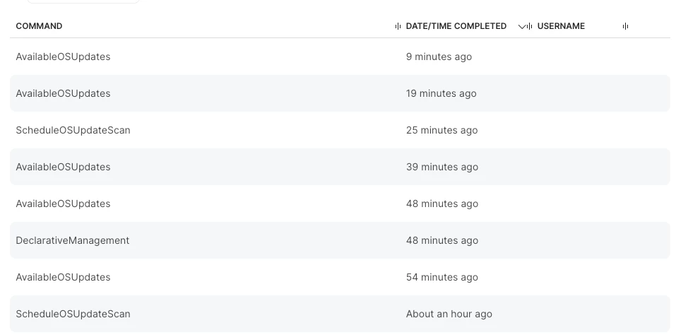

  • Nov 8, 2023 3:40 PM UTC
Hi guys,
to add my stone, I launched an initial DDM command to upgrade my Sonoma from 14.0 to 14.1 without a hitch, I wanted to test again from 14.1 to 14.1.1, and that's where it's more complicated, I've reviewed the discussions a little and here are some inputs I can provide
DDM settings can be found here :  `/var/db/softwareupdate/SoftwareUpdateDDMStatePersistence.plist`
I found quite a few errors of this type in my install.log :
2023-11-08 16:32:36+01 name mdmclient[50106]: -[SUOSUMDMController _availableUpdatesUsingAppleSoftwareLookupJson:withLegacy:WithError:]: MDM conflicts with DDM, ignoring OS updates`
and now Jamf is trying to restart DDM actions in a loop on my device.
I've tried your trick of turning the option off and on again in the Jamf console, but I can't solve the issue.
I'm going to open a ticket to the support team, as I assume this is not normal.
