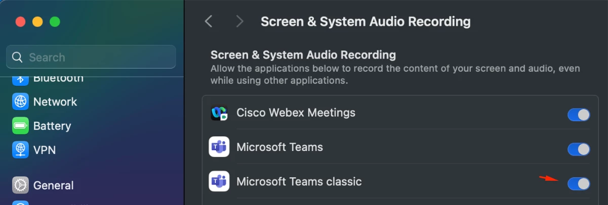

Hey Guys,
Is there a way to export a report that confirms which users have the screen and system audio recording setting toggled on? The goal is to export a list of users with any settings enabled in that area.

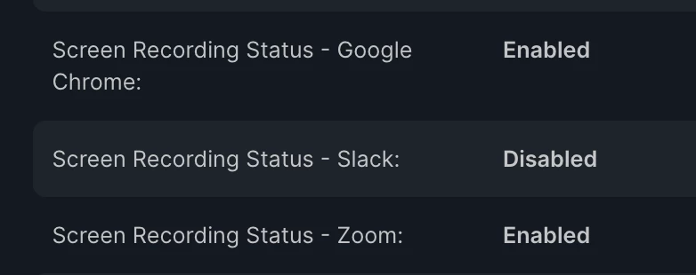

I found something that might be helpful but it's not working 100% yet. Check this post out on Medium, it says its tested on macOS 13 so a bit dated. Trouble I am having with the EA is hat the result reports as "Disabled" no matter what if it's toggled on or off.
Forum|alt.badge.img+22
  • Nov 20, 2024 9:20 PM UTC
@Alvaro1337 I got this working. Use that EA and make sure Full Disk Access is enabled for Terminal
