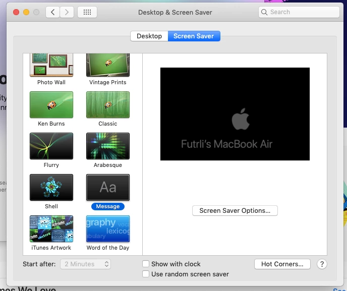

I have run into a strange problem where the screensaver settings seems to be greyed out and defaulting to start after 2 minutes. I have not created a configuration profile for the screensaver so confused where this is coming from.

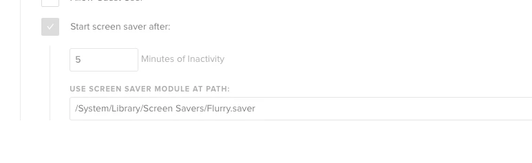

In testing the issue, I have created a separate configuration profile where I have added a login window setting to start the screensaver 5 mins after inactivity. Upon restart this does appear to work where the option in system preferences is greyed out but showing 5 minutes, however upon another restart/log in, this then goes back to 2 mins (and back and forth etc).

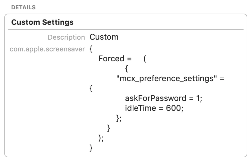

I wasn't even aware there was a PI for this, but that's exactly what I've done to get that setting to apply. Jamf Pro doesn't have anything built in that actually applies that screensaver setting reliably for the logged in user. Some people point to the LoginWindow setting referenced, but the truth is, that actually is intended for the login window, just as the name implies. That's why some people who use it find it flips off and on after reboots. The only reliable way to set it is as a user level profile with a Custom Settings payload. This is the one I have for that:
It works perfectly, and locks the setting so it can't be modified by the end user:
