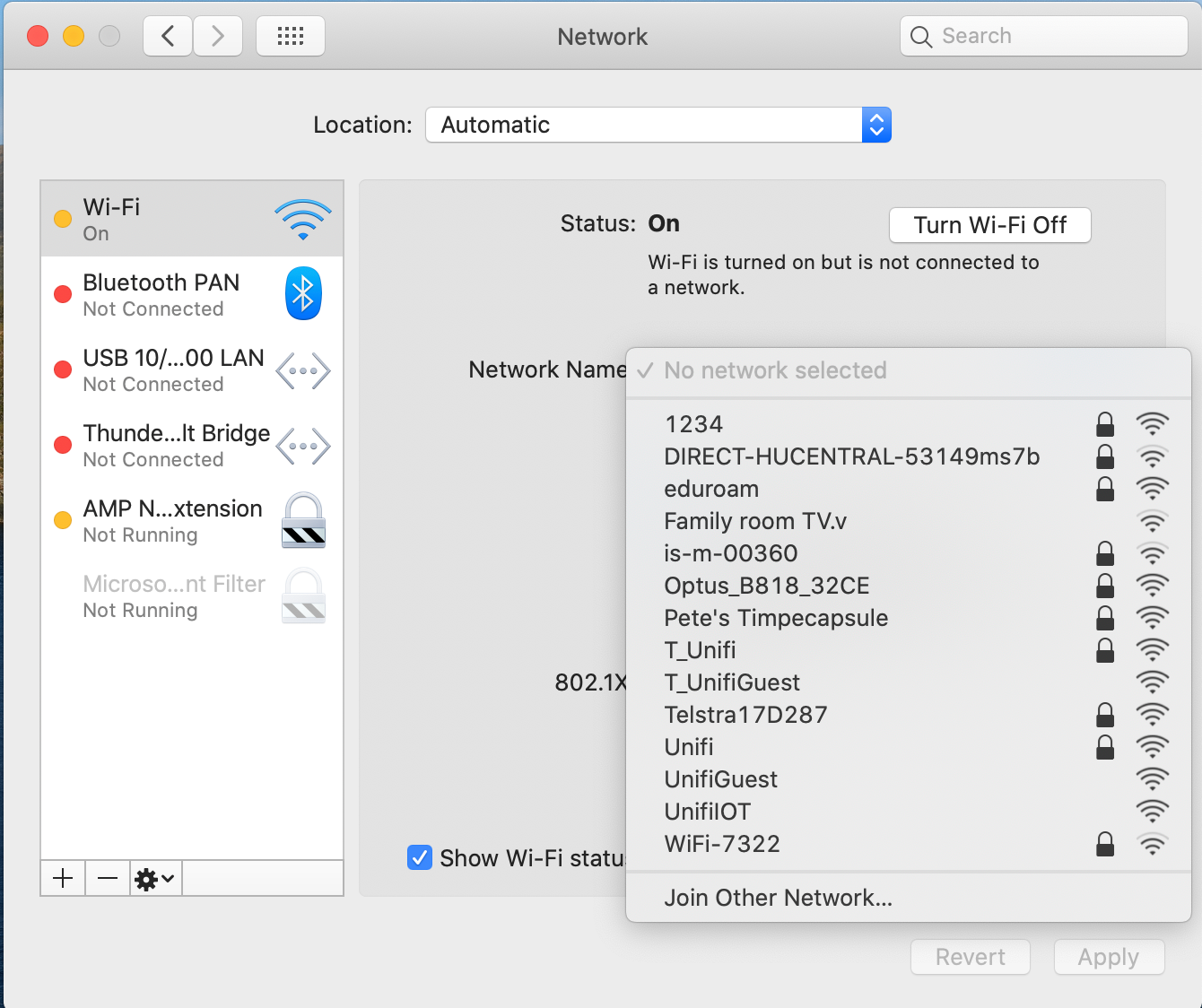

The first thing I found was that the wireless "Unifi" is not set up as the default but am hoping there is some way to to fix
But I can at worst manually choose the correct one

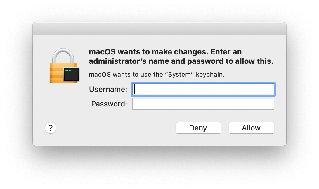

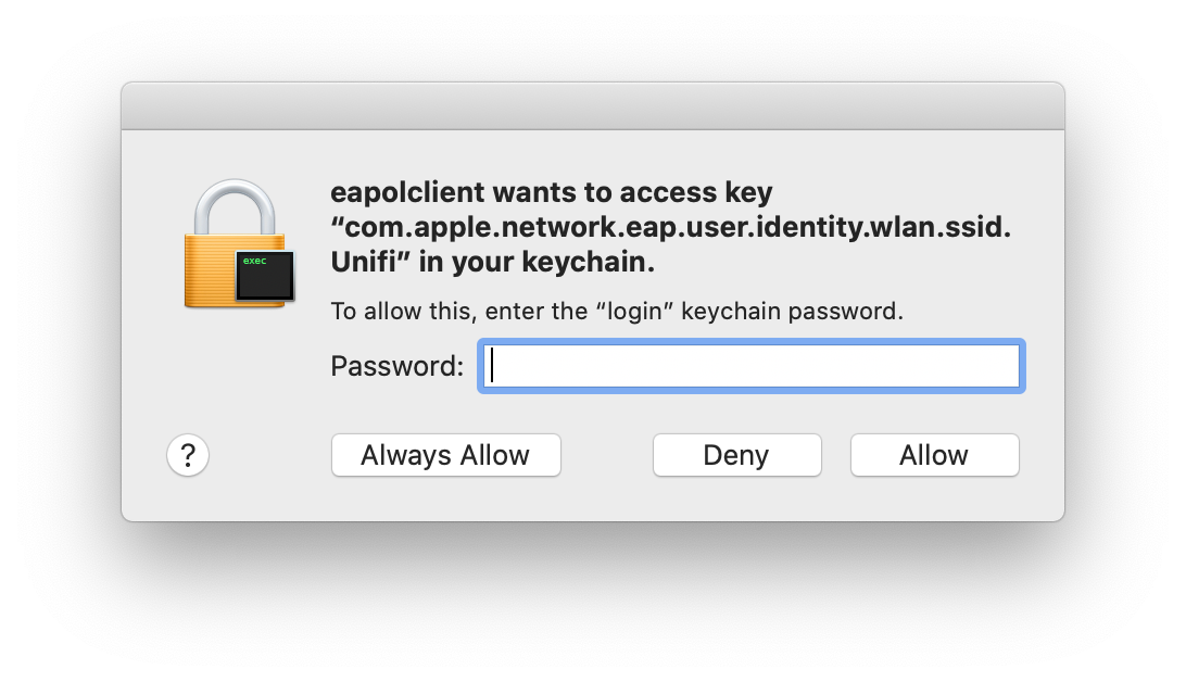

Then the user is asked to allow eapolclient to access the logon keychain
This is the one I'm most worried about because it's asking for access to the system keychain. For the life of me I can't see a way to do that in the command line and I'm not sure what is wanting that access.

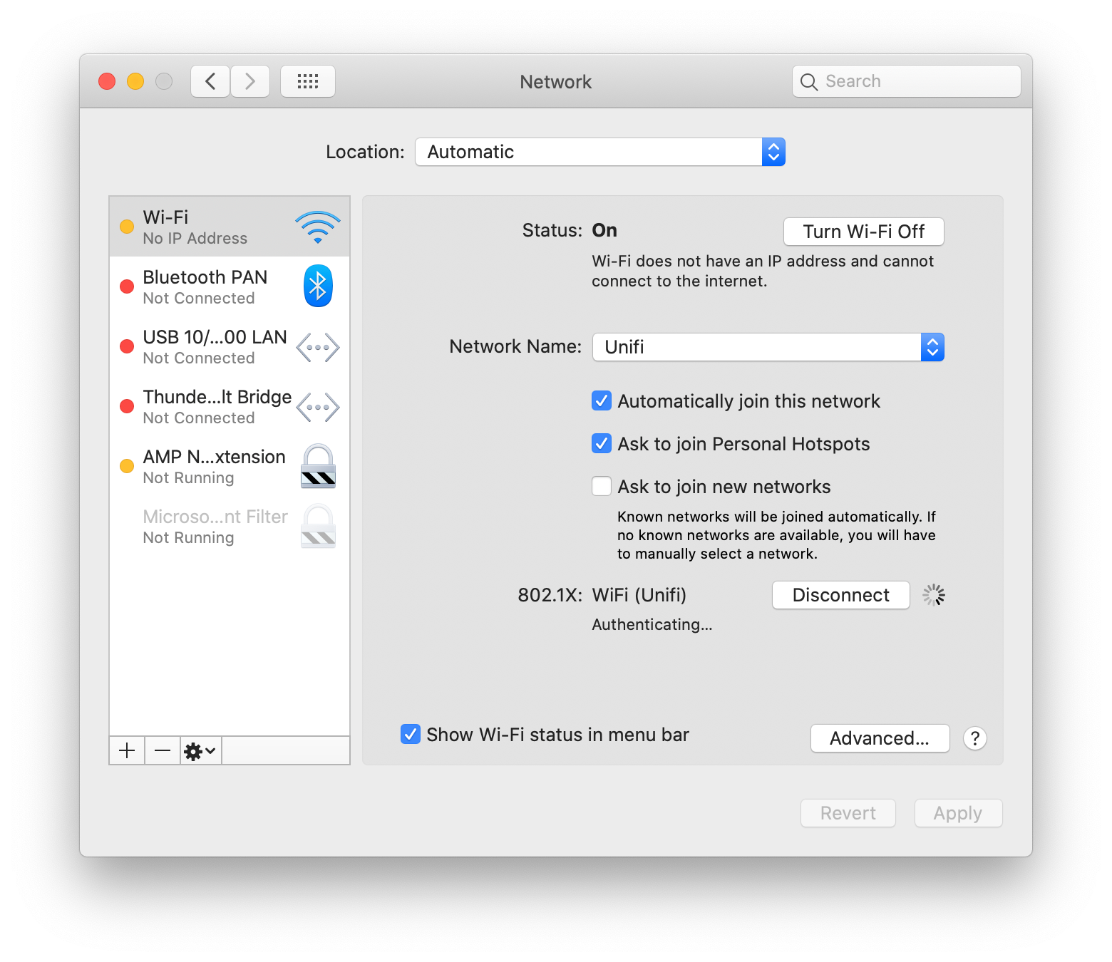

The last issue is that when all this is set up I get this and I have to disconnect and then reconnect via the button before it actually

Sorry @mwilkerson no success with the admin prompt for System keychain
  • May 19, 2021
@dlondon I discovered yesterday that if I dismiss the admin credentials prompt (hit esc or click Deny), it joins the wifi network anyway... So, even though it comes up, it doesn't seem like it's even necessary. Now if I can just get it to not prompt at all....
