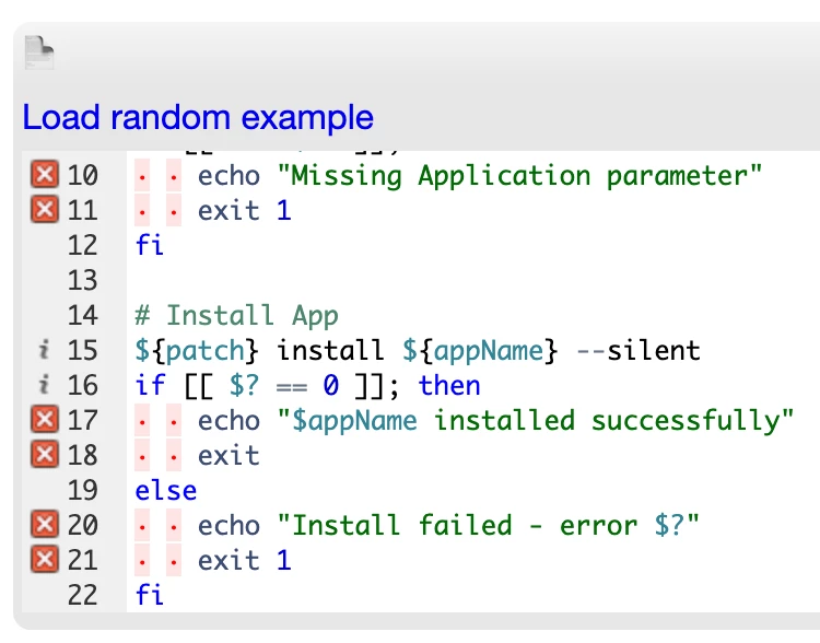

JRM5513
  • Aug 16, 2026 12:36 PM UTC
ShellCheck tells there are unicode non-breaking spaces (line 10,11,17,18,20,21). You should try to delete and retype them.

chris.woods413
  • Aug 19, 2026 11:53 AM UTC
That is probably a result of me pasting the script into the post, but thank you for reminding me of ShellCheck. It did highlight some other issues which i fixed in the script
