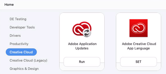

@DanielDarnbrough have look at this example from another discussion in Jamf Nation.
Self Service - Get User Input with Script
We use a lot of osascript inside bash scripts here when we need to get users' input.
Furthermore as we have a global customer base we try as much as possible to localise the messages to make the process easier for all, and AppleScript (osascript) allow you to do that.
Other options:
JamfHelp is good but limited.
After that you are looking in installing another tool to support the task when osascript is native to the macOS (for now at least).
@Nix4Life We use the same concept (osascript inside bash) for Adobe CC Installs.
This allow us to offer multi-language installs with one single Adobe package/app.
All the end user has to do is choose the language for the Adobe app and after that the installation is set in that language.
Saved us a lot of policies and HD space.
Also that follows the same concept of localisation, the prompt is in the user's language.
Here is the "sanitised" example of our script to illustrate the osascript part.

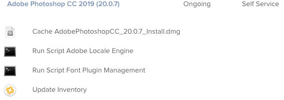

Attached the screen shot of the policy for illustration.
PS: We write a local file with the chosen language for subsequent installs, so this prompt is done once unless the user requires another language, which is available via another self-service policy.

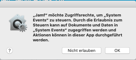

If I run the script, I was asked to allow Jamf to control System Events.
Is there a way to configure this using a configuration policy or something else?
  • Jul 24, 2020 11:44 AM UTC
Hi @oli,
You'd need to whitelist Jamf using the AppleEvents: Creating Privacy Preferences Policy Control profiles for macOS.
Untested but this may be a good start for you: Jamf_All_Notifications_v1.mobileconfig
oli
  • Jul 24, 2020 11:58 AM UTC
Hi @shaquir ,
thank you for quick responce! I will give it a try.
Best regards!
