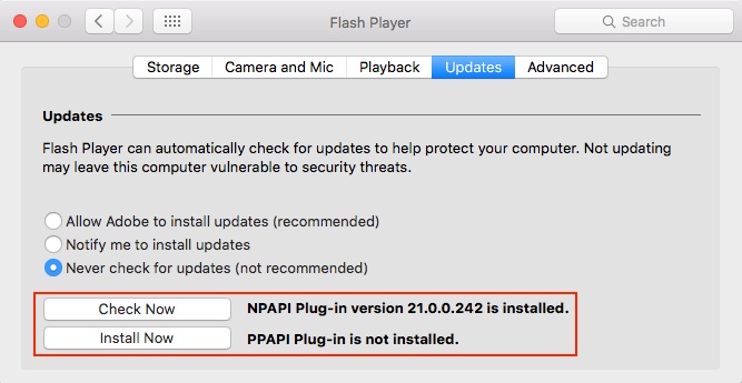

Anyone know if there is a supported method to grey out the two Update buttons in the Adobe Flash Player preference pane?
donmontalvo
Forum|alt.badge.img+36
  • July 28, 2016
Adobe posted a response:
I've been trying to find a reference to the directive to not push settings.sol in our documentation, but I'm not finding it the administrator guides (I only went back a few versions). That said, it sounds like reasonable guidance. I was just curious about any context that might definitively clue me in to the reasoning at the time. While you could probably configure a player instance the way that you want it, then push out a settings.sol by default, I don't believe that's a use-case that we've explicitly designed for, and could be problematic over the long term, should we need to change the implementation in the future. Historically, decisions to support clever solutions have come back to haunt us as painful engineering constraints and intractable legacy problems. Should we find ourselves in a position where changing the handling of settings.sol is necessary to solve an engineering issue, having multiple supported paths for enterprise client configurations could force us into a painful stance where we have to make a hard break with compatibility, which we try diligently to avoid. My guess is that this has already happened in the past, which led to the original guidance, or it's a very real concern for a particular domain expert at a given point in time. It is an internal configuration file, and with a codebase that's been in active development since 1997 and the number of places inside the player that it intersects with, it's plausible that we've made design assumptions along the way about it's availability and integrity. At the very least, it would be difficult to definitively assert the inverse. The supported path for configuring client behavior in an enterprise environment is to distribute a customized mms.cfg to your clients. There's a comprehensive list of directives in the system administrator's guide, here: Adobe Flash Player Administration Guide for Flash Player | Adobe Developer Connection As a general rule, mms.cfg directives take precedence over user settings, so even if the relevant panels are available, users shouldn't be able to override your settings. For any high-risk scenarios, it would probably be worth double-checking that assumption for peace of mind, but it should hold true and we'd be happy to help if bugs bubble up through that evaluation. If you're running into a scenario that you can't solve with the current set of directives, we'd definitely like to know about it. We invest a lot of time and effort into making life easier for network administrators, and when it's feasible, we're happy to try and provide additional pain relief.

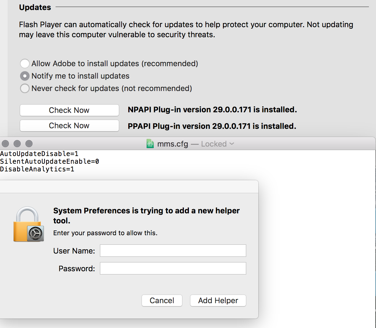

Thanks All. But this doesn't disable users to change the options. Is there a way to Grey out option to never check for updates.
donmontalvo
  • July 12, 2018
@ukspvmalapati our script still works with 30.x. As the Adobe Engineer mentioned, this greys out the boxes.
This will overwrite the existing file, but then we manage that file and we know we want those three lines, so we're good.
# Create folder path if it doesn't exist.
mkdir -p /Library/Application Support/Macromedia/ 2>/dev/null
# Disable auto updates
echo "AutoUpdateDisable=1" > /Library/Application Support/Macromedia/mms.cfg 2>/dev/null
# Disable silent autoupdates
echo "SilentAutoUpdateEnable=0" >> /Library/Application Support/Macromedia/mms.cfg 2>/dev/null
# Disable analytics
echo "DisableAnalytics=1" >> /Library/Application Support/Macromedia/mms.cfg 2>/dev/null
Result:
# cat /Library/Application Support/Macromedia/mms.cfg
AutoUpdateDisable=1
DisableAnalytics=1
@donmontalvo -- Thanks for replying. Here is the screen shot which shows, an Admin user can change the update settings.
Those radio buttons were not greyed out. Hope screenshot gives more details.
