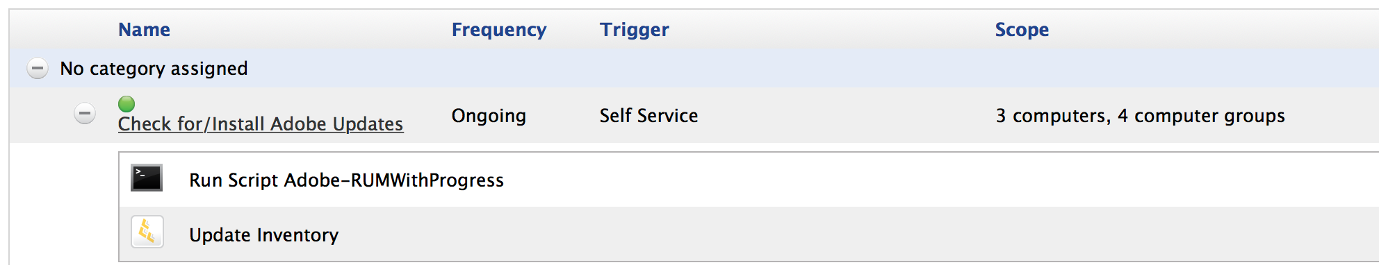

Best answer by mpeski
Have a look at this: https://github.com/jmahlman/uarts-scripts/blob/master/Adobe-RUMWithProgress.sh. We use this in our environment and it works very well.
12 replies
  • June 16, 2017
  • June 16, 2017

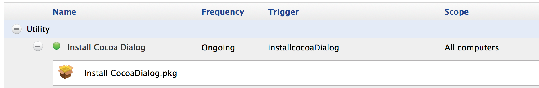

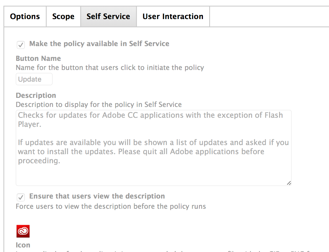

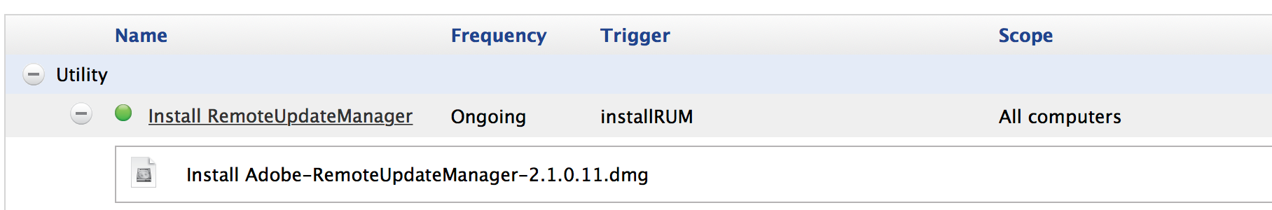

@mpeski This is amazing! Thank you. Cocoa dialog is handy tool. Much much smother than trying to have apple script involved.

@mccaskill We have one policy that installs or updates the latest RemoteUpdateManager. We make sure all clients have the latest version. we download the latest version here: https://helpx.adobe.com/creative-cloud/kb/rum-update.html. With Composer we make a pkg of it that we then install.
We use this EA for checking the version of it: https://www.jamf.com/jamf-nation/third-party-products/files/876/adobe-remote-update-manager-version-ea.
And we use a Self Service policy that users can use to update the Adobe applications if they want to. It's just an ongoing policy that runs this script. That's all basically.
jmahlman
  • January 10, 2018
@mccaskill Hey, I wrote that script. I should probably add some notes to it for people to use it. Here's what I have setup to make it work.
  • Make sure users have cocoa dialog and RUM on their systems. We put it on our systems at image time but if someone doesn't have them the script will try to install it via policies (I install cocoadialog via pkg to /Applications/Utilities/ and just use the RUM installer created with the Adobe packager)
  • Upload the script to the JSS and create a simple Self Service policy. I make it do an inventory update after it runs.
And that's all! We make it available to everyone all of the time.
