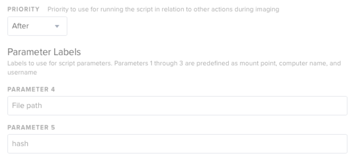

The script uses the 4, 5, and 6 parameters in the script GUI interface. Once I add the script to the policy, I can add the Application install path to check in 4, the Application name in 5 and the custom install trigger in 6. The script will check for AppName-Error.app where AppName is defined in parameter 5, and if it doesn't exist, check to see if the Application path, defined in parameter 4, exists. If both of those conditions are true, the script reports a verified install success. Otherwise, the script creates an install fail condition and tries to install the application again.
