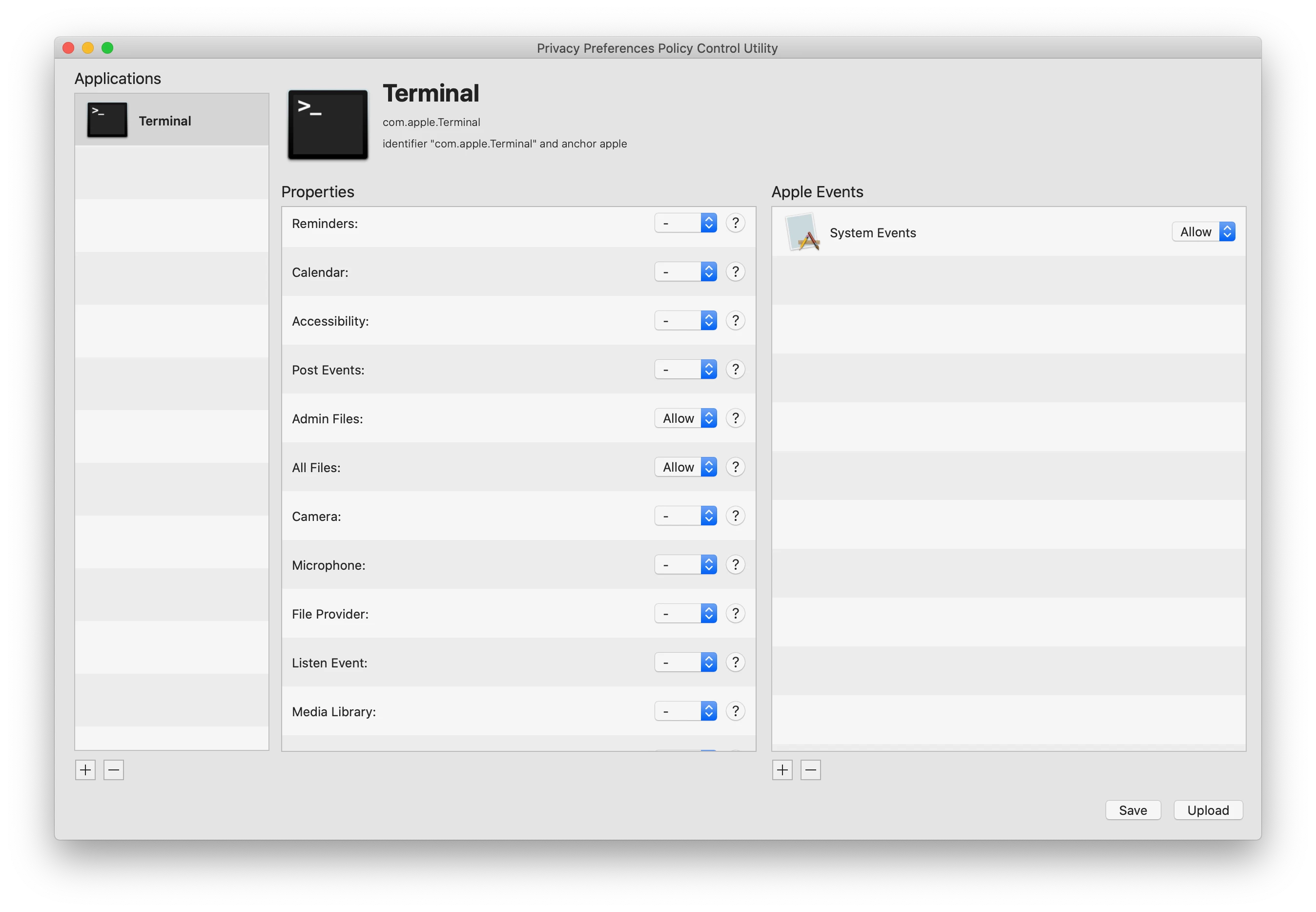

Hello Jamf Nation!
I have a script we've been using to install various apps in Self Service that no longer works in 10.15. Wondering if anyone can tell me why.
It worked fine in 10.14. In 10.15, I can run it in Terminal from the logged in user, but I can't get it to work when I run it as a policy.

When running this as policy in 10.15, I get the following error (for every app we attempt to install in this manor):
�  - [Chromium] Downloading app...
unzip:  cannot find or open Chromium.zip, Chromium.zip.zip or Chromium.zip.ZIP.
mv: rename chrome-mac/Chromium.app to /Applications/Chromium.app: No such file or directory
It appears the script can't download (or find?) the file. I guessed that maybe new security protocols in 10.15 were preventing Terminal from having access to pull and view downloaded files, so I created a PPPC profile to ensure it has access (attached). But still the same error.
Just wondering if anyone has any ideas as to why this might be happening... Would love to get these scripts working again--and quickly.
