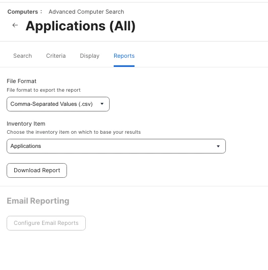

Anyone know how to get an exported list of the applications?
dpwlg
  • Oct 30, 2024 11:10 AM UTC
You could search for Applications and use "*" as the criteria. That will give you a list of everything inside the directories that you're inventorying.
Yeah, but I need a quick report to export to provide to my manager. I found a way by using that search criteria for all my computer group I had and then downloading the report choosing the option for applications. :)
