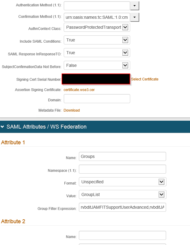

Well my SecureAuth engineer was able to fix this out. The response I got was-
It was the “SubjectConfirmationData Not Before” setting. I set it to False… and now it works.
That's all I got, hoping this helps someone else.

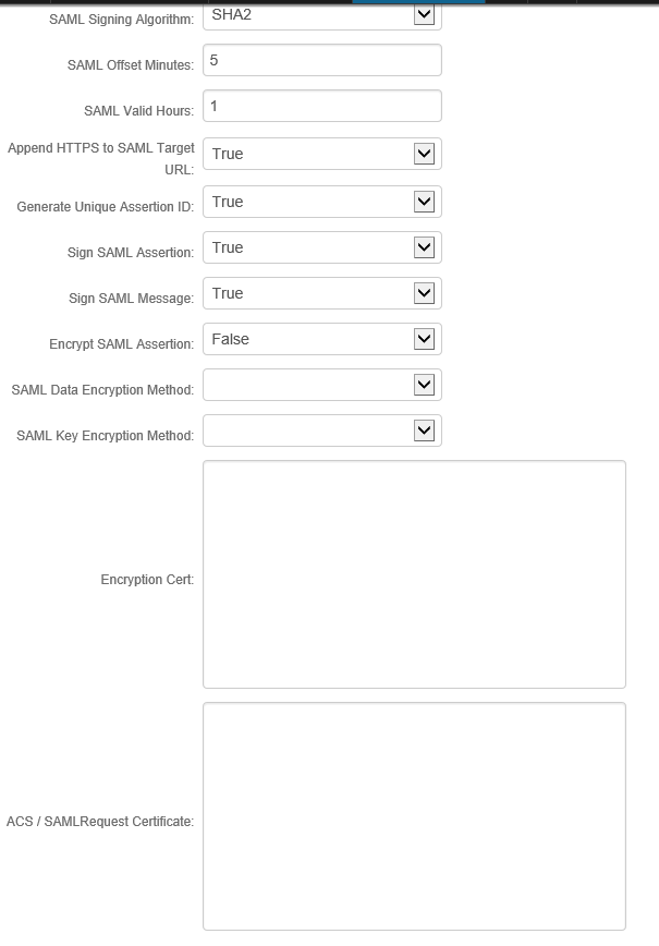

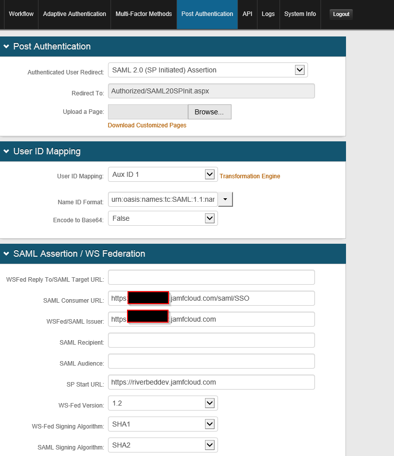

  • September 1, 2020
Sharing screenshots of our working POST Auth config in SecureAuth version 9.2 using group based auth in saml assertion. Make sure to have these groups created on Jamf side. Also, tested to support user matching via UPN attribute. If matching against user accounts, make sure to have the full UPN value created on Jamf side.
