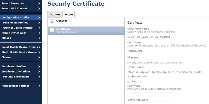

For JAMF, I just deploy a config profile with the Securly cert, users are then directed to log in with their Google account to auth
Cert can be downloaded from here at the bottom:
https://support.securly.com/hc/en-us/articles/212511418-Casper-JAMF-iOS-Configuration
Give it a whirl in your test environment!
