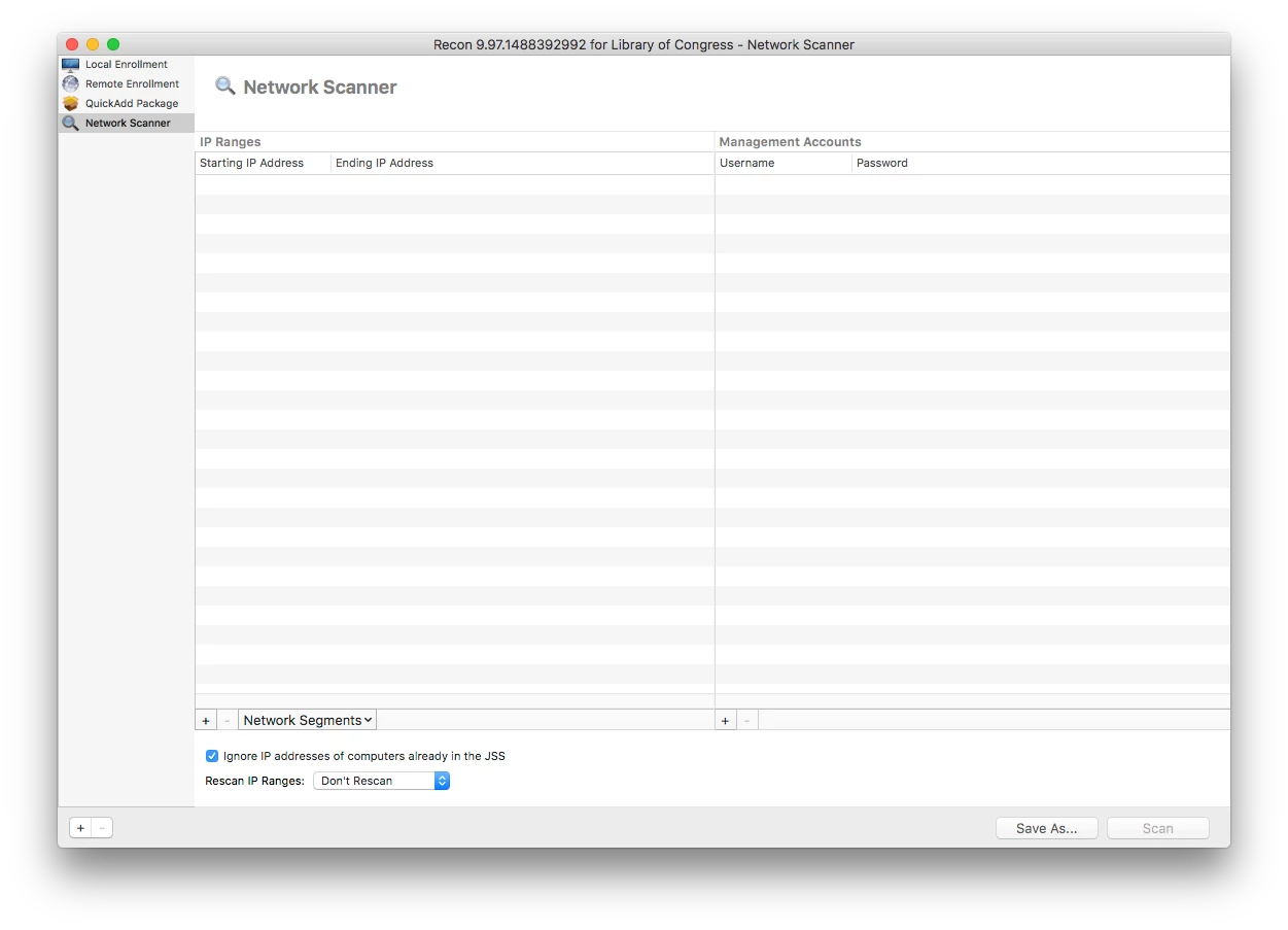

In the future, you could also try Recon app to scan your network of any Macs and enroll them.
scottb
  • July 7, 2017
If you do like @mvu suggests, while it may work, be prepared to possibly get a call from your network/security folks.
I'd ask before pulling that trigger...I know from experience ;)
