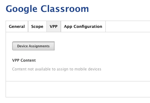

Yes, I see the non-free apps in Global Management --> VPP Accounts --> Content. The free ones do not show up there.

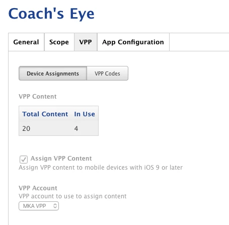

On Free App Store apps, In Mobile Devices --> Apps --> Select the App --> VPP Tab, I see a "button" for "Device Assignments" but when I click on it, nothing happens. Yes, the Edit button is checked in bottom right.
On Purchased VPP App Store apps, I see the same "button" for "Device Assignments" and when I click on it, it gives me options for assigning to a mobile device. However, on the iOS side, it's still prompting for an Apple ID.

For the "google classroom" app which is free, I had to go into apple's vpp and basically purchase it again with the amount of licenses I wanted. The content it supposed to refresh in jamf, but doesn't always so I had to manually add it with update purchased content. It was very tedious to have go back and do this for all the free apps already setup in jamf.
The steps I did to ultimately get this to work were as follows:
1. Purchase an app through vpp, didn't matter if it was free or not.
2. Go into jamf>global management>vpp>ensure the app is listed in content. If it isn't then update purchased content.
3. Ipads have to be iOS 9
4. I have had better success if they are enrolled through DEP pre-stage enrollment
5. Assign the app as you have for "Coach's Eye" with the vpp account.
PS: I was able to have all my redeemable codes transfered to managed distribution licenses.
damienbarrett
Forum|alt.badge.img+19
  • December 1, 2015
Ah ha! I think it's because I didn't actually "purchase" the free Apps in the VPP portal. Doh! That would explain why the one app shows up as device-assignable but the free ones don't. I'll test this and report back. Thanks for the walkthrough and steps.

I noticed in your screenshot for Coach's Eye that you also have VPP Codes available for that app. I ran into an issue when testing Device Assignments, if there were any VPP Codes assigned to the app I was attempting to deploy, then the device would prompt for Apple ID credentials. As soon as I deleted the VPP codes from the app, then the Device Assignment worked correctly. So keep an eye out for that too!
