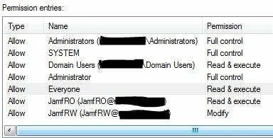

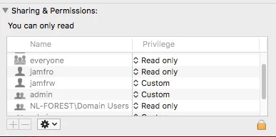

Hi All,
Having issues with Self Service for reasons unknown?!
Looks like someone had edited the permissions which broke the share but this was fixed and put back to normal but no one can install packages. The share can be mounted manually and packages run.
Please see attached my permissions and the error in jamf log which is no help at all.
Top is windows server permissions second is what mac users see.
