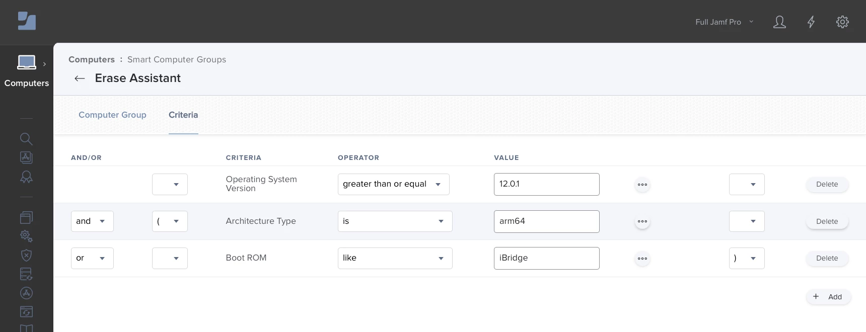

Smart Group
Erase Assistant
And / Or CriteriaOperatorValue
  Operating System Versiongreater than or equal12.0.1
and(Architecture Typeisarm64
or Boot ROMlikeiBridge)

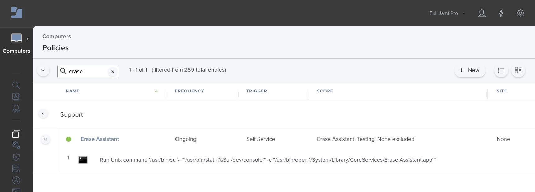

Policy
Options
General
  • Display Name: Erase Assistant
  • Execution Frequency: Ongoing
Files and Processes

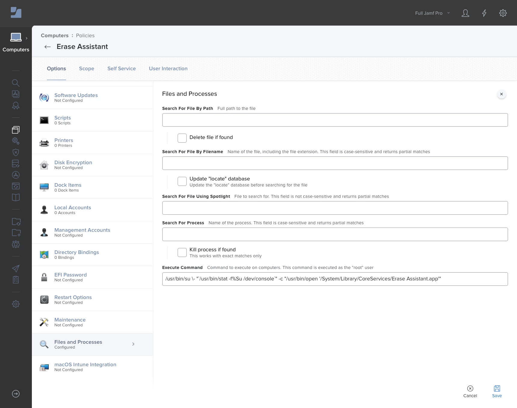

    • Execute Command:
/usr/bin/su \\- "/usr/bin/stat -f%Su /dev/console" -c "/usr/bin/open '/System/Library/CoreServices/Erase Assistant.app'"​
Scope
Targets
      • Erase Assistant

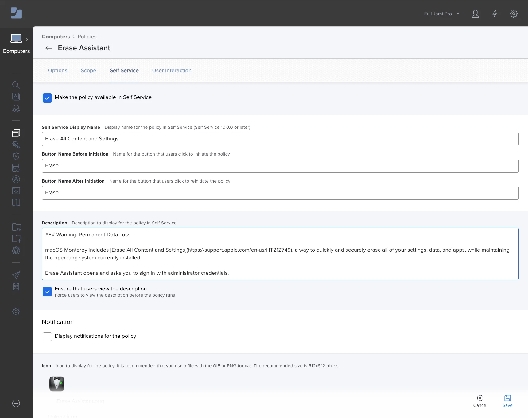

Self Service
      • Self Service Display Name: Erase All Content and Settings
      • Button Name Before Initiation: Erase
      • Button Name After Initiation: Erase
      • Description:
        ### Warning: Permanent Data Loss
        macOS Monterey includes [Erase All Content and Settings](https://support.apple.com/en-us/HT212749), a way to quickly and securely erase all of your settings, data, and apps, while maintaining the operating system currently installed.
        Erase Assistant opens and asks you to sign in with administrator credentials.

There seems to be a discrepancy between the screenshots and the text for the command. In the screenshots there are ` in the first image and none in the second. The text to copy is also missing them. I cannot get this method to work because I am unsure of what the actual command is to call to Erase Assistant to open and run it. Thanks.
dan-snelson
Forum|alt.badge.img+30
  • November 10, 2021
Thanks for the feedback; hopefully this will work better:
/usr/bin/su \\- "`/usr/bin/stat -f%Su /dev/console`" -c "/usr/bin/open '/System/Library/CoreServices/Erase Assistant.app'"
Jared_Y
  • November 10, 2021
Thanks that worked!
