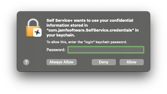

I installed it to test and after launching it and/or the classic version, I get prompted twice with the below message.
Ondrej_Krupka
Hey @SMR1 , which version of Jamf Pro are you running, please?

SMR1
  • Jan 24, 2025 1:46 PM UTC
11.12.1

Matthew_T
  • Jan 24, 2025 7:37 PM UTC
Same on both here as well. Running 11.12.1
