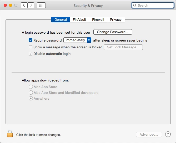

maybe modify these settings in security prefs pane
