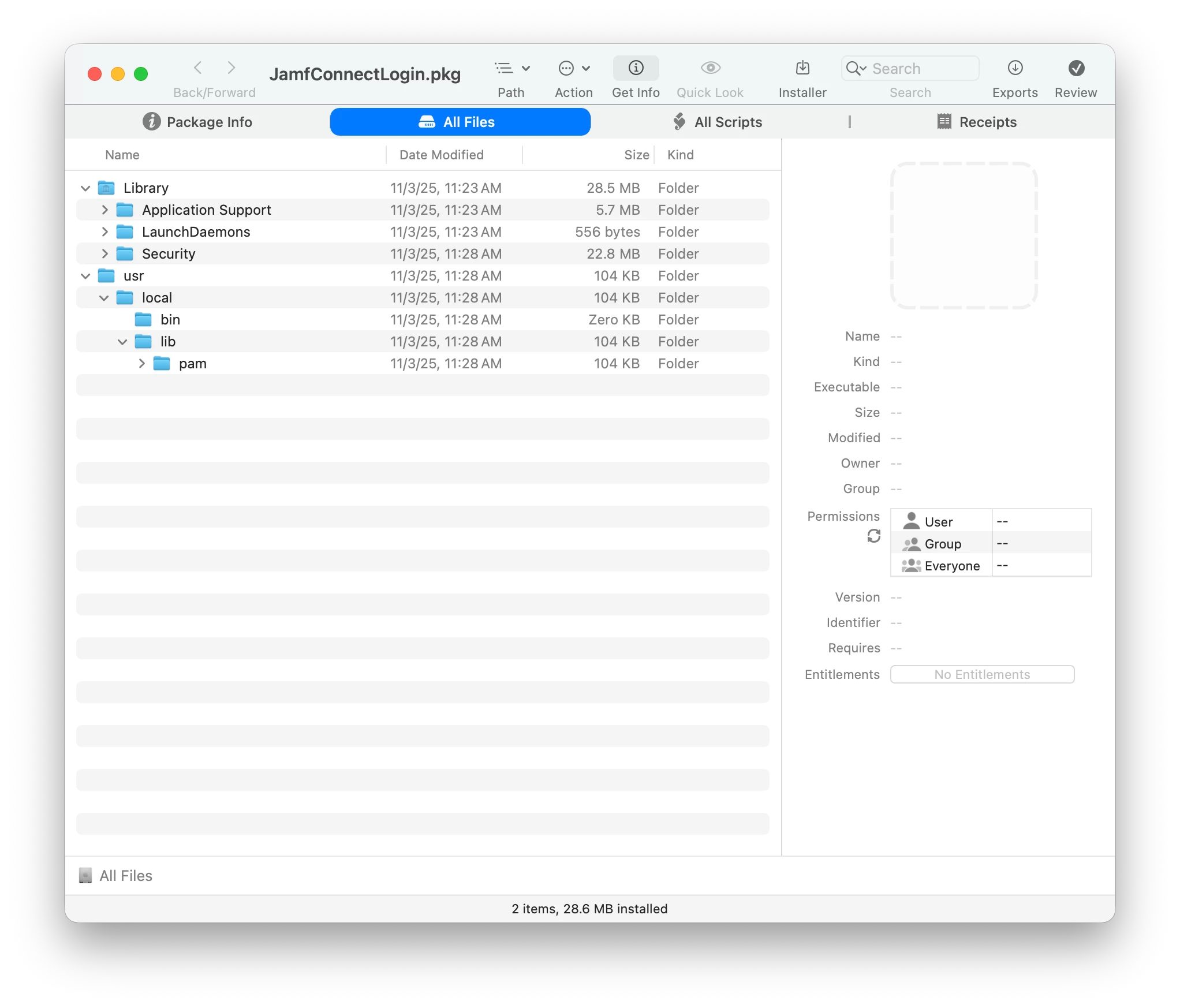

MatthewPalasz
I am also trying to resolve the Tahoe ‘keychain’ issue we are seeing with JAMF Connect.  I downloaded the JAMF Connect 3.5 updater and tried running the install package which is now called “JamfConnectLogin.pkg’.  The package installer says that it runs and completes, but doesn’t install the app.  As far as I can tell it installs some support files, but not the app itself.
Suspicious Package contents for JAMF Connect pkg installer

Hey dsonzera, MatthewPalasz, samuel.24323 - I just wanted to jump in to help try and clear some things up. The fix that was released for the keychain issue is resolved by updating to Jamf Connect Login 3.5.0. When you install the Jamf Connect Login 3.5 package available on Jamf Account - you will only see that the Login piece is updated to 3.5 as Menubar is no longer packaged with Login since the 2.45 series. That is why you don’t see the app within the installer package. With that said -  there are folks out there running Login 3.5.0 and 2.45 menubar without Self Service Plus just fine. Generally speaking though it is best case scenario to be fully updated on all fronts to ensure the smoothest experience in case that changes. For this issue though - the only piece needing updated is Jamf Connect Login 3.5.0. I hope that helps clarify!
Tyler Wehrman

Ahh, that’s so helpful ​@tyler11, thank you!! Since the keychain pop-up was the menu bar app (or SS+ in that linked post) requesting access, I missed that the root issue is just on the Login side.
Our normal method of updating JC has been the “Jamf Connect Deployment and Update Settings”, and version 3.x isn’t available in the dropdown. I assumed that’s because we’re still on Self Service classic, which took me down the SS+ path.
But if grabbing the 3.5 Login package and deploying it in a policy is all that’s needed for the keychain issue, that’s much easier! (Though yes, we’ll still prioritize the SS+ transition afterward :)
