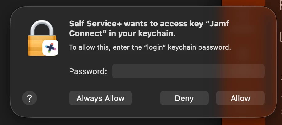

I can not get this prompt to close no matter what I do. Everything in the back end seems fine with my machine and my connection to Jamf, self service, connect, everything, it all seems fine. Anyone have any ideas?  I did not see this issue prior to updating OS from 26.0.1 to 26.1 and that is the only thing I can think of that may be triggering it.
I have tried deleting associated keys and allowing them to regen, I have tried flushing and re-pulling Config Profiles and Policies. P&S settings are all good. I have fond that if I leave the window there for 30min or more, it will finally close after entering PW and selecting Always Allow, but then comes back up after Reboot.

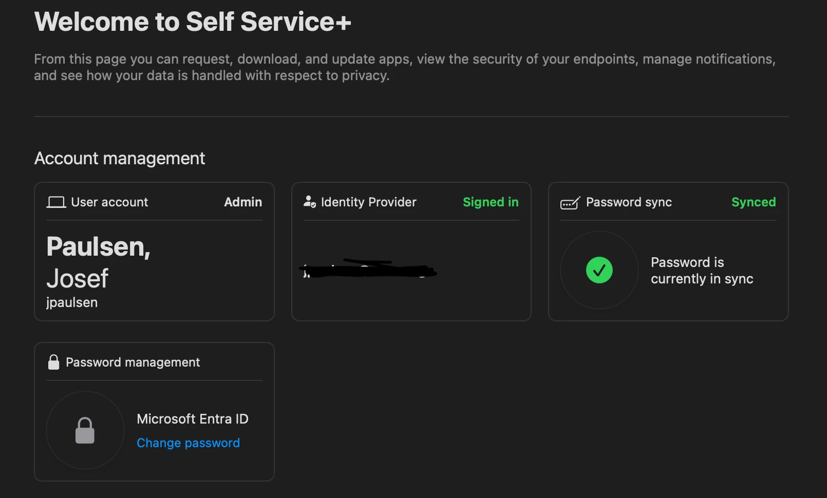

I am a little confused… I have JC 3.7 installed and SS+ but I get the keychain pop-up. Then I was told that I don’t need the Jamf Connect launch agent, so I tried re-installing without the agent, but then it disables the actual Jamf Login at the Mac Login screen, and I cannot have that. I am possibly doing something out of order.
But then if I install the launch agent, my SS+ dashboard does not display the PW sync as intended.
