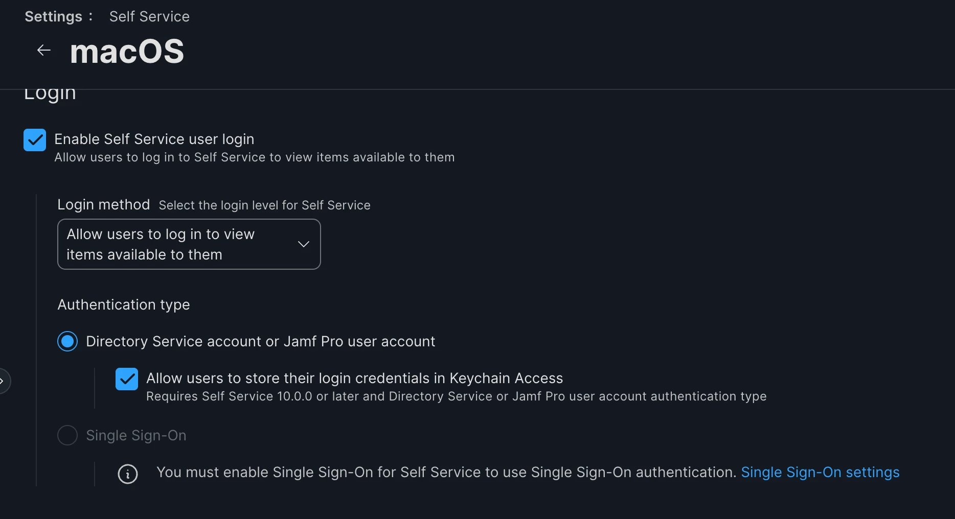

GCozy
  • Aug 11, 2025 10:42 PM UTC
We had the same issue and we were using Shib for our SSO. Everywhere else was letting us do SSO (enrollment, jamf pro server) but not self service. I went digging and found a setting that enabled it for us without changing the group mappings as that was already working for us with dev and prod for the sign on experience.
Look under Settings>Self Service and change the login to SSO. Once we did this we saw the SSO experience in the Self Service app.
