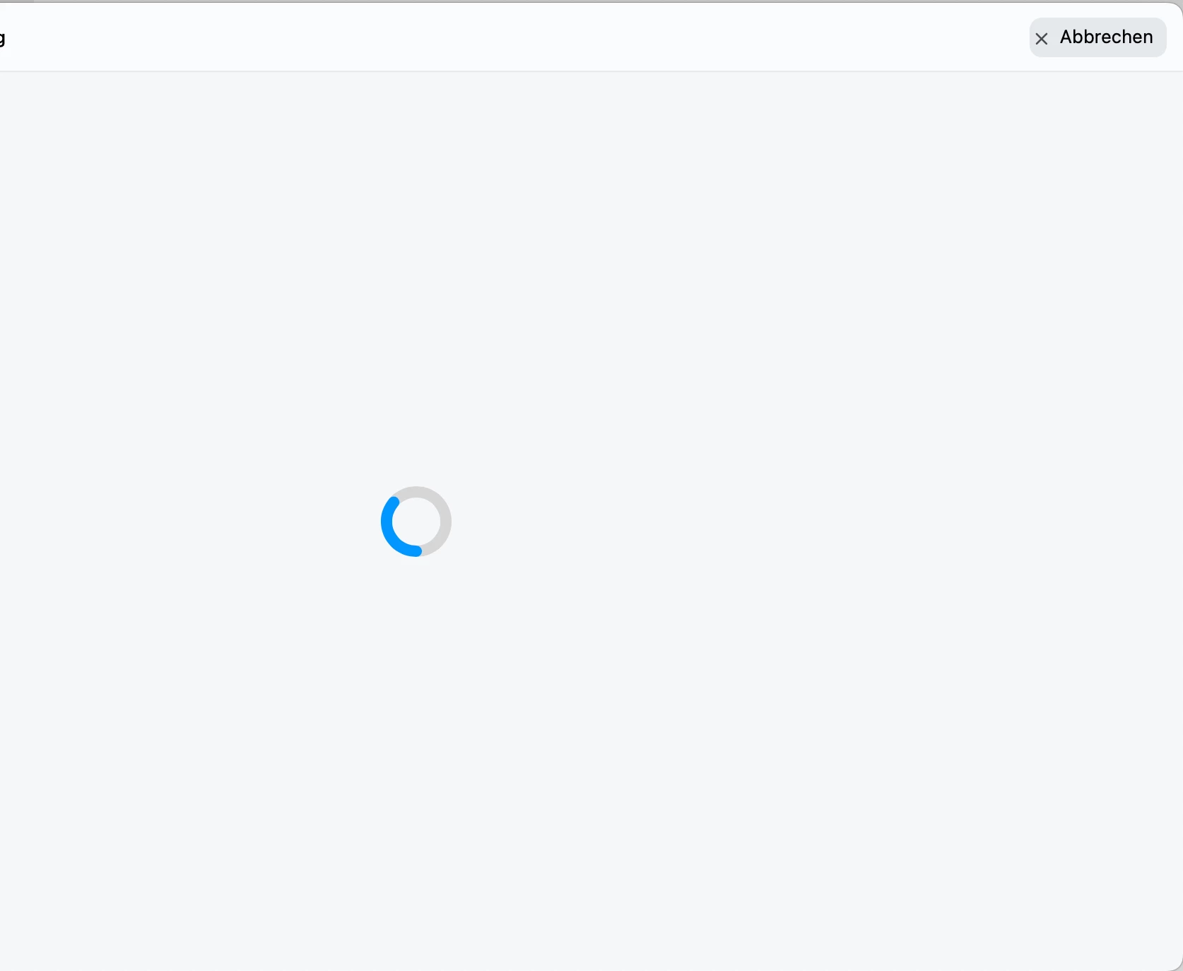

Hey all
currently we have the problem that some users can no longer log in to SelfService.
We have turned off our LDAP server and switched everything to Azure AD with SSO.
We have also changed the configuration so that a login does not have to be required in SelfService. However, after clicking the login button, only a white screen appears:
However, this does not apply to all users. Network and Internet can be excluded.
Does anyone have any ideas?
